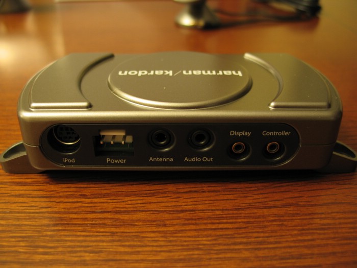

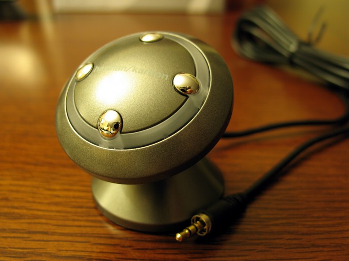

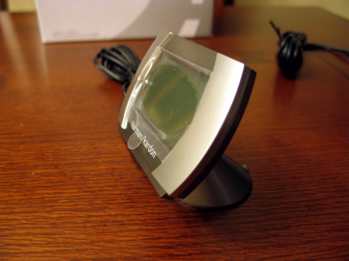

I got to play with one last night as I tried to install a set on my VW Passat. Last week, I installed the OEM ipod adaptor on my cooper.
Background:
The OEM Mini adapter is brilliant I think. Controls are fully integrated into the head unit. 5 playlists are even accessible through the radio presets. The downside of the the OEM adapter is the Ipod display is not available, so you have no info other than track number about what song is playing. Another downside is it cannot co-exist with the CD changer. You have to give up the CD changer.
The Harman Kardon product is new and highly publicized as a good Ipod solution for any car. The big upside is you can tuck the Ipod away and have a screen on the dashboard that shows all the info. There is also a controller in a convenient position that is Ipod-like and optimized for a car.
First impression is man, that's a lot of parts! Check out the first complete parts photo. Luckily the manual is pretty thin. This gave me some assurance that installation can't be that hard.
The good:
- The screen and the controller are very high quality. They are attractive and built with high-grade materials. The controller rim can be turned left and right and has a nice tactile feel.
- The ipod is charging when connected and the volume output is optimized automatically.
- There are many options offered for mounting and wiring. This is one of the reasons why there are so many parts included. You can power it with direct wiring or a cigarette lighter. You can integrate it with the car stereo through low-level outputs, fm airwaves or fm direct line.
The bad:
- installation is a pain. There are a lot of parts. You have to punch a hole in your dashboard for the display wiring. You also have to find a spot for the controller. The ideal spot is between the shifter and the handbrake. A lot of cars don't have room here. In the Mini, there seems to be room beside the mirror adjusters. Finally, there's all these wires. There's many wires 3x the length you need and you can't really cut them easily
- You really need to power this unit with an 'accessory' wire that shuts off with ignition. Otherwise, it's always on and you have to unplug the cigarette lighter plug everytime you need to turn it off or exit the car.
- Volume is done through the head unit.
- This system is really ideal if you have line inputs to your stereo. If you have the 'aux' mod, this might work well for you. Otherwise, you're stuck with FM integration. FM airwaves transmission is bad. It's bad with any product. It's bad with this product. There's a choice though. For an extra $30, you can have FM 'wired-in' integration through the car antenna. I was eager to test this but then I find out the antenna FM kit doesn't work in the Mini, VW and most european cars. You can get plug adapters from Crutchfield for $40. Nice... right.
So, I'll try and post more pics of this in the Mini later. Meanwhile, I'll have to figure a line-in solution if I want to use this product in my VW. I actually have a tape adapter there and that might work. I'm testing it for a site called audioreview.com.
