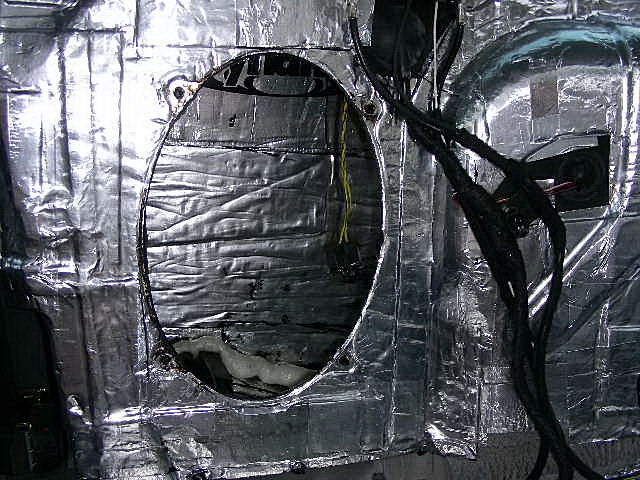

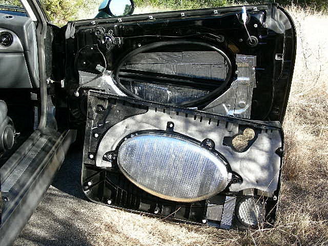

Dynamat will probably reduce exterior sound (I've heard an aftermarket upgraded MINI blasting 120+ dB inside, and you can't hear it outside). Also some people claim Dynamat will improve their cars bass levels.
You can read about an extreme HK upgrade here (not GBMINI!)
