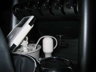

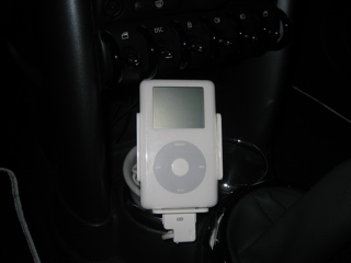

YES you can use the Aux input and the ipod docking port
I have my ipod connected to the ipod docking port and the mini aux input. It works great. :smile: How did I do it? Belkin has two products that I use but you only need one. Use the Belkin ipod auto kit available at Amazon. http://www.amazon.com/exec/obidos/tg...&s=pc&n=507846
It connects to the cig. lighter for power, use a short adapter cable to plug from the Belkin unit to the aux adapter. The ipod plugs into the belkin unit using the docking port. The ipod signal is passed straight through to the aux. input! You can control volume from the steering wheel and you can adjust the input level on the head unit (I use level 2). Really very easy and elegant except you cannot change tracks from the steering wheel. But if you mount the ipod using the Belkin "TuneDoc Car holder" in the cup holder you can easily reach it to change tracks. It is fairly easy to install the aux cable without taking the dash apart by reaching behind and feeling the connector. Here are some instructions: http://mini.uglydoris.com/archives/000028.html
So for less than $40 for the adaptor (Classic MINI is great!! I bought my MINI there!!) The ipod auto kit $29.84 at Amazon and the car holder @ $14.44. You have a great solution. Sound is great. Hope this helps. Steve
