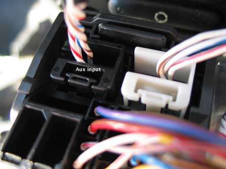

Nice. Thanks for all the help everyone. I got it installed fine but I did have to take the radio out as I couldn't reach behind it to plug it in. I have small hands so I thought it would be easy. It wasn't too bad. Here's a few pics. Yes I still don't have a digicam yet. Only my Nokia 3620. LOL.
yes that's a Lamp. Don't ask. lol
halfway done!!
The plug!!!
almost finished. putting radio back in.
and bam it's finished!!!!!!! I ended up mounting the input on my large cup holder right between the 2 silver metal frames and tied them off with the tieoffs. It accually came out nice. The 2 pics I took came out small for some reason but once I get a better camera i'll post some better ones. Thanks for all the help.

Too bad you had the build the whole thing out, I managed to do it with my small hands and with the attached picture where the bottom of the picture is the top side of the radio I could feel my way arround.
