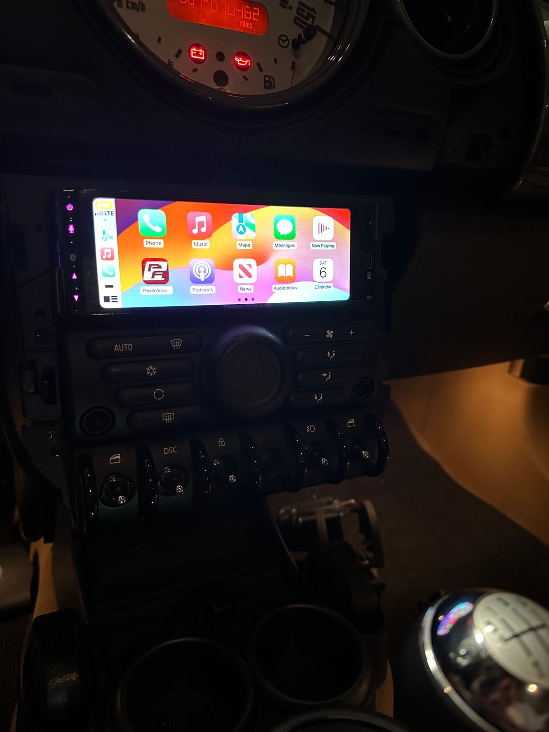

Awesome CarPlay / android auto option
Just bought an R53 that had a system installed - pretty high end stuff ten years ago when it was put in by a prior owner. I am a bit of a tech snob and NEED CarPlay in my cars. There are some really crappy quality single-din CarPlay stereos on Amazon / eBay, and few from quality manufacturers. While scouring the internet options I found some classic Ferrari owners are installing this unit from Power Acoustik and have nothing but praises for it.
https://www.walmart.com/ip/Power-Acoustik-CP-71W-Single-DIN-6-5-Color-Touchscreen-Car-Stereo-with-Bluetooth-Connected-Apple-CarPlay-Android-Auto-New/5055269224
I installed it yesterday and it sounds fantastic, and moreover it’s as responsive and functional as the oem CarPlay stereo in my Infiniti suv. It’s a great option if anyone is looking to upgrade their technology in their 1st gen.

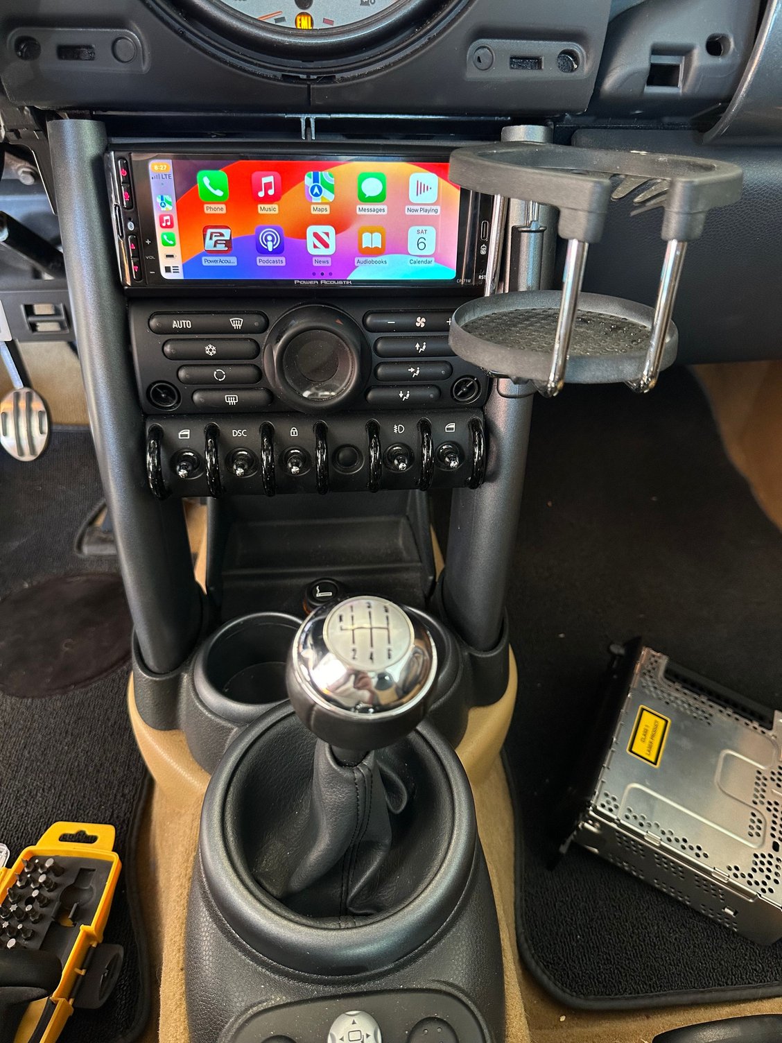

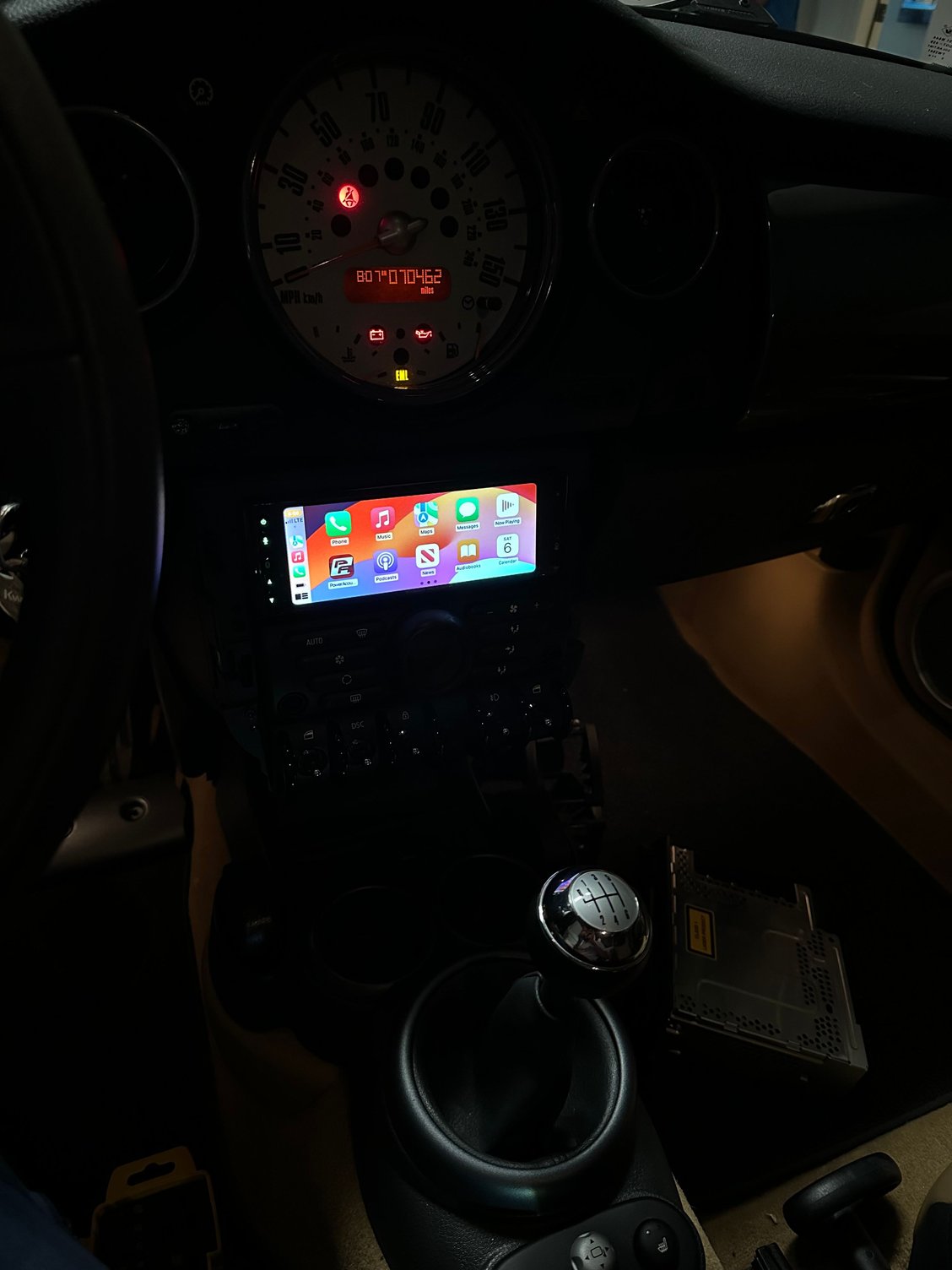

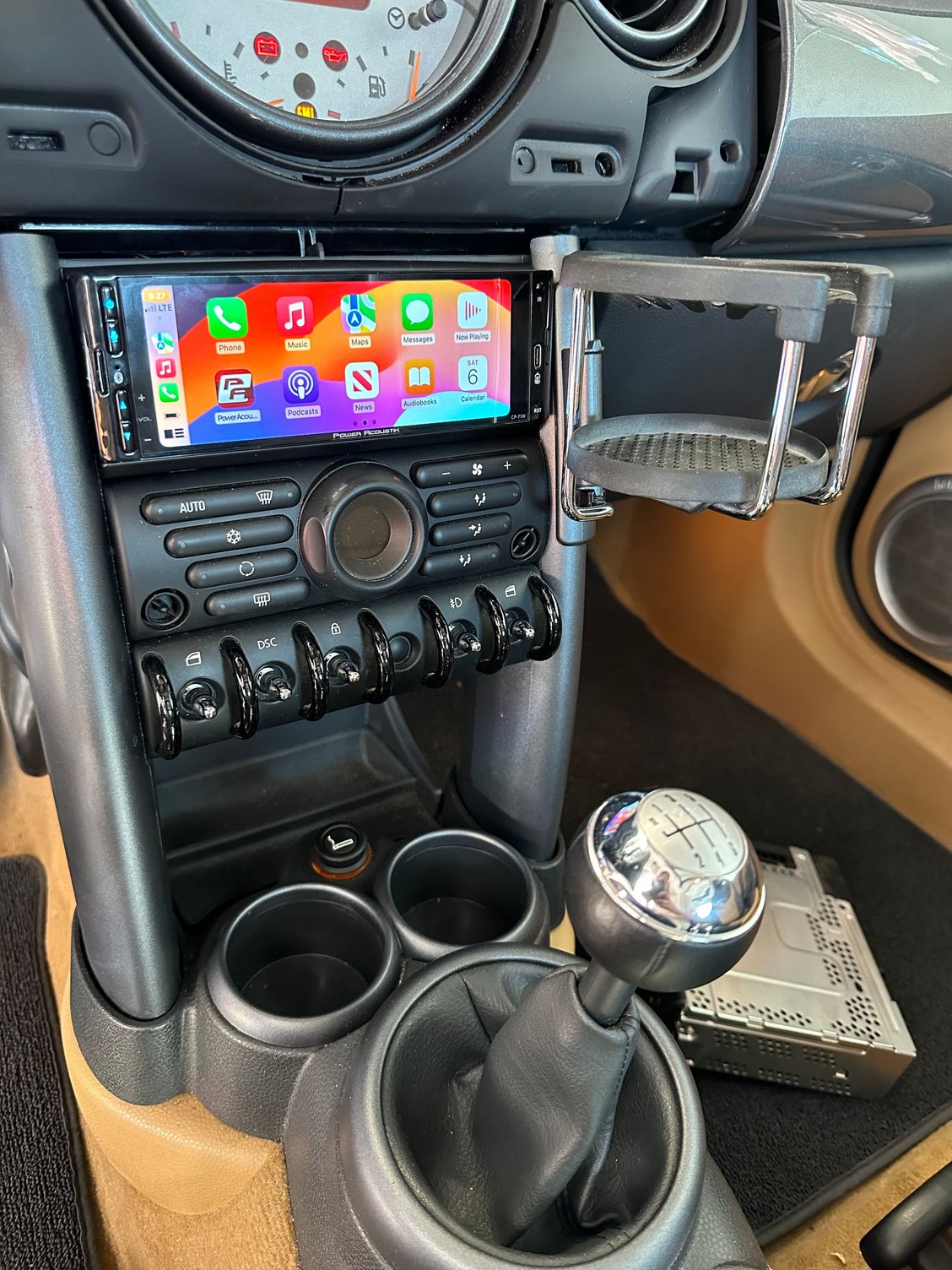

Funny - I was just about to create a thread with this exact setup. Had it a while but was waiting for my HK enabler to come from across the pond.
Saw so many S2K/older Porsche/Ferrari guys raving about this quick and cheap fix to modernize their older cars. I have to figure out my SWC since the adapter I was given doesn’t work but it’s not a deal breaker for me.

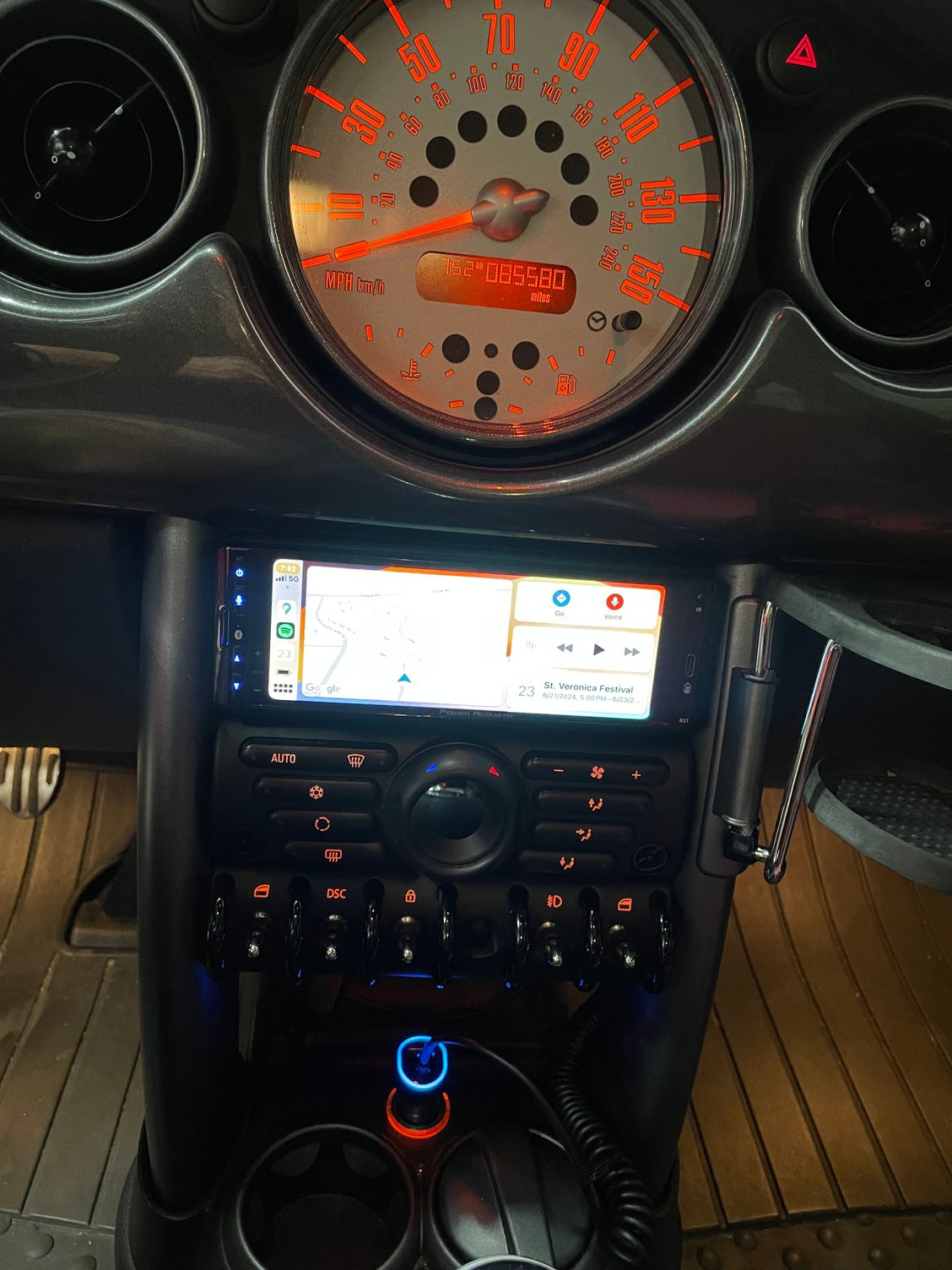

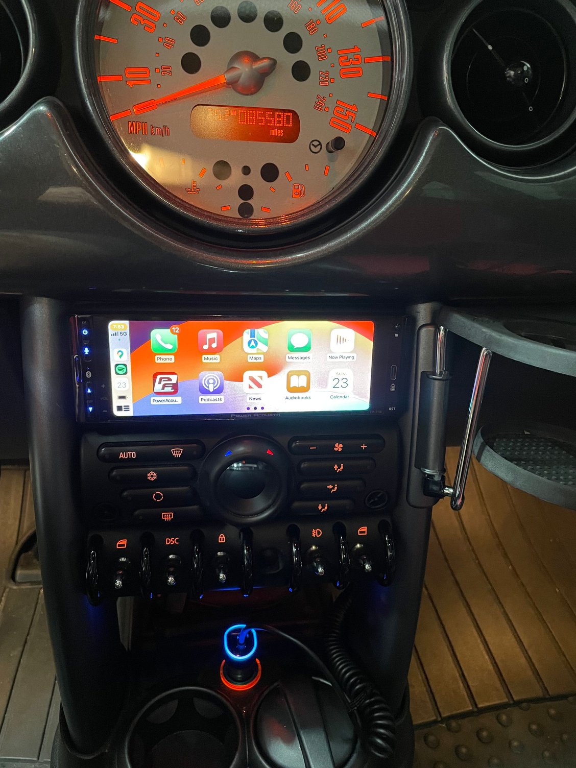

Looks great! You will definitely dig it. 2 weeks in and I’m still really impressed with the stereo! My car had a quality system installed when I bought it that bypassed the HK setup, but mine sounds incredible with a 60x5 amplified system / sub.

I also just noticed, what happened to your gas needle

Holy hell! That's aweomse - both the fuel and temp needles are visible in the photos! haha. Must just be reflection becuase they are both definitely there. lol

ya the picture make them look like they’ve disappeared
