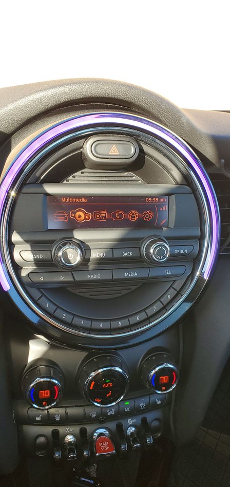

Just got my '16 mcs and it has the worst HU I've ever seen, from what I've been reading, doesn't look like much options and I'm stuck with it. Can anyone point me in the right direction to either swap with an aftermarket HU or swap it for one of the higher trim HU's?

it's a catch-22 here. can you do the swap...yes...you'll have to have the radio bench-coded prior to install or you risk locking it (permanently?). secondly, and this was the deal breaker for me...the radio doesn't actually fit in the dash. unfortunately, mini made 2 dashboards. 1 for the base radio and 1 for the 6.5/8.8" radio. that being said, someone has put it in, but they used zip ties so the headunit itself isn't really mounted but floating in the dash...putting that aside the screen (either size) fits. i did not like the idea of ziptieing the nav/headunit so i stopped working on the project. ultimately, i got rid of my S and picked up a JCW that had a 6.5" screen so i'm all set.

After market h/u will lose a lot of the functions that you need. Oil level check, TPMS, etc. I've emailed several Asian vendors and they all dance around the issue because they want to sell product, but so far I've yet to find one that works. If you could find the space (not easy) to mount the OEM h/u you then could install an after market unit. You can probably find brackets now for mounting the better MINI h/u but it isn't worth the money IMO.
Currently I am playing my music with a DAP (digital audio player) via Bluetooth to other after market equipment. I'd like to mount a tablet computer for this function, but it isn't easy in this car.
Good luck, let us know if you find something. I'd still like a h/u.
