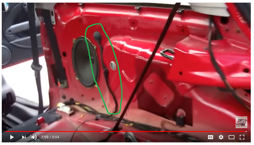

If accessing the rear speakers is the only way to get to the rear speaker wires (aside from going through the head unit), is there a place that I can tap into and carry the wires so that my lines for the subwoofer are not pinched underneath the speaker boarder/edge? This would be related to picture 1, is the green encircled wire harness the speaker wires?

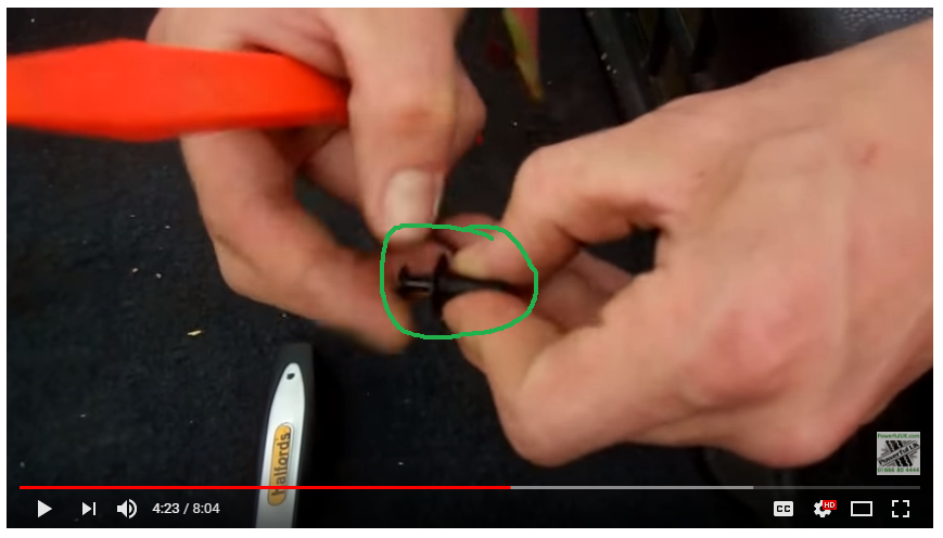

With regards to doing the full disassembly to access the rear speakers, does anyone know the part numbers (or an equivalent working parts) for the rivets/clips in pictures 2 and 3? It seems as though there are multiple of the rivet clips from picture 2 in the trunk and side moldings and there are four of the yellow pop rivets from picture 3 in the trunk molding. I just want to have some on hand for when I possibly/likely break the originals during the installation.

Picture 1: Exposed wall panel with a wire harness arm/extension
Picture 2: Rivet clip found in the trunk and side wall moldings
Picture 3: Yellow pop rivets found on the trunk molding

You do have to remove the whole rear plastic panel to access the speaker wiring. I can tell you from my own experience with a set of cost effective 16x9s there is no shortage of bass, unless you want your neighbours to hear thum, thum a block away. When I did mine I added small amount of acoustic mat to the sheet metal. Those factory paper cone speakers are worthless so the biggest bang for the buck is to change them all out. Efficiency is key and you can achieve very good sound with just the amps in the modern aftermarket HU that are all bridged amps.

I did not take note of the speaker wiring access but common sense tells me MINI designer take the least distance to route the wiring. They must run along the sill (likely on passenger side) which is a PITA to intercept there, and to the rear speakers.

I think I found the parts that I referenced in pictures 2 and 3. For anyone else looking to replace the plastic bits (on a pre-facelift R53), from realoem.com wall panel and boot panel pages:
- The black expanding rivets in picture 2 are part # 51118174185. There are three of these on boot trim panel.
- The yellow clips in picture 3 are part # 07131503417. There are four of these on the boot trim panel and six on each wall panel.
- There are three spring clips (part # 07149198818) in each wall panel that were pointed out in the video.
- There are three expanding nuts (part # 07130672440) paired with three self-tapping screws (part # 07146977198) in each wall panel. These look like they will survive reuse if not cross threaded.
