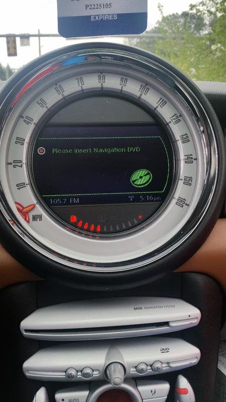

I have a 2010 MCS Mayfair that was originally built in Germany. The previous owner seems to only given the 2010 European DVD Navigation disk. I can put this disk in the system and it will show the roads in Europe, and shows my general location on a blank US map (you can zoom all the way out and see I am in the Southeast). I have been to the service dealership here in my area, and they are having issues finding a DVD update disk that will work in my DVD-based Nav head unit.
Does anyone have a 2009-2010 DVD based Nav system in their MC and have updated since 2013? I need the part numbers off the dvds or the packaging to help to find somerthing that I can use to make the Nav work. The new 2015 DVD update would be the best part number, but anything newer than 2012 would help. Below it the unit that I have. It is the DVD only version, not the CD player based version. I have a set of TomTom 2014 CDs as well, but they do not read in the drive (the dreaded "Insert Mavigation DVD".

Here is the link for the updates.
2015-1 NAV DVD (MINI CCC) CCC based. 65902365698 Professional 2007-2010
http://www.ecstuning.com/Search/SiteSearch/65902365698/
2011-2016 with CiC system ( USB unit used ) and updated in upper glove box https://www.northamericanmotoring.co...-what-for.html
https://www.ecstuning.com/b-genuine-...2/65902365693/ ( Now NLA) BUT somone posted up the data from the USB file https://www.northamericanmotoring.co...-update-2.html
https://www.ecstuning.com/b-genuine-...x/65902365695/ Old school nav 2002-2005 MINIs R50-R52- R53 with CD based ( no DVD marking on dics unit)
OR
2015-1 NAV DVD (IBUS) 65902365697 High 2005- 2008 R50-R52-R53 MINIs with old school DVD based driver.
http://www.ecstuning.com/Search/SiteSearch/65902365697/
