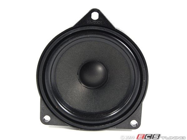

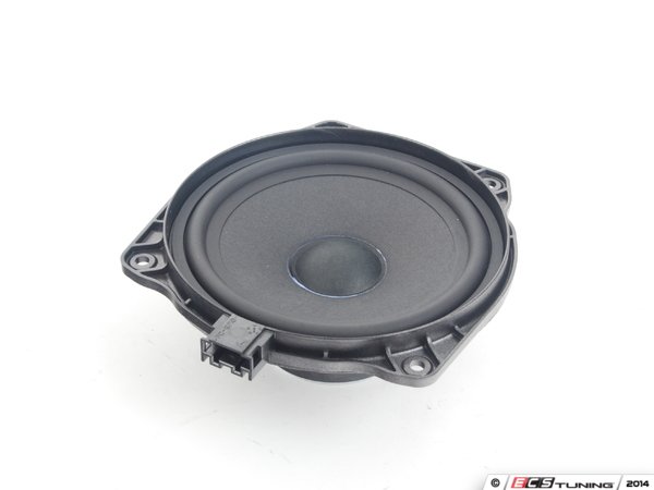

http://www.ecstuning.com/Search/SiteSearch/65133422637/
HiFi Midrange Speaker - Priced Each 65139143153
http://www.ecstuning.com/Search/SiteSearch/65139143153/
