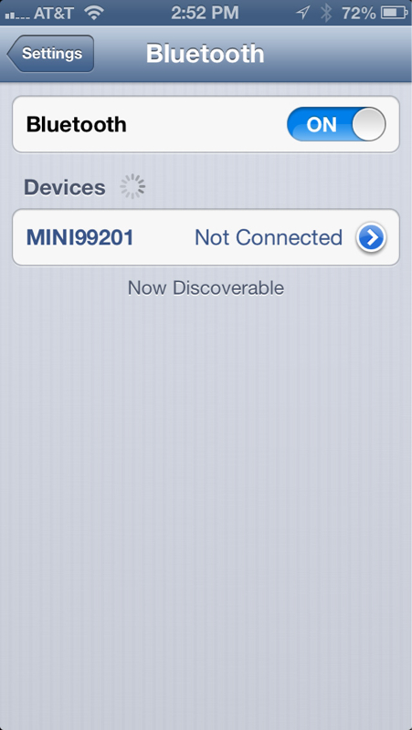

There is a thread I think called MIMI Connected text message iOS 6 where absolueczech gives step by step. As far as I know no updates have been given by MINI for email as of yet.
Attached Thumbnails Connected questions and I am not finding answers-image-2686607340.jpg

Ok - I think I've got it figured out... I now can view unread Messages and Mail on the Connected's Screen. Here's what I've done, although honestly I'm not sure exactly which of these steps resolved it... As a reminder I have an iPhone5 with IOS 6.1.3.
First I updated the MINI Connected Software in the car by downloading from www.mini.com/connectivity.
Un-Paired the phone (Select "Forget Device" on iPhone)
Under Notifications, ensured both Messages and Mail are set to View in Lock Screen.
Paired the phone to the car again. On the iPhone opened the options for the bluetooth connection to the MINI and ensured Show Notifications was set to On. Waited a few seconds and launched Office. Now additional Office functions appear when clicking the joystick to the left.
