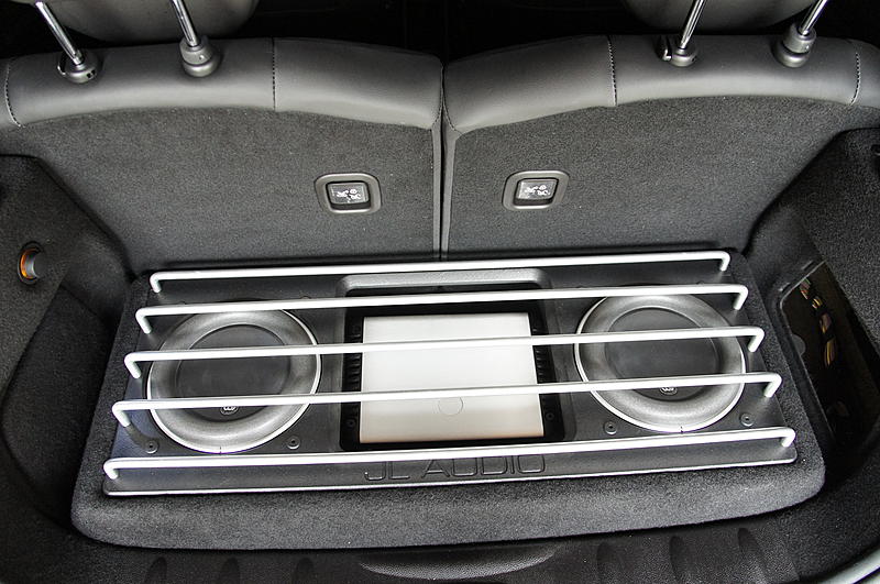

First of all I want to said HI to everyone! I'm a newbe & just got my 11 JCW (black w/red top) I been reading alot of the thread about stereo & was very helpfull to me! thanks to all the hard work everyone posts. my set up is: front spearker: focal K2 power 165kr2, rear: 690 CVX 6x9 (don't know should I run the rear or just have front & sub?) sub: JL stealthbox w/two 8" w7 (see picture) amp: one JL HD 750/1 (rear sub) & one HD 600/4 (front) one good thing that I like the JL sub box is they fit two HD amp in the middle! just hope if someone could help me if I should just run K2 w/600/4 w/o the focal crossover (one channel each speaker) or run the 600/4 to front K2 & rear 6x9 hope to hear some good feed back, thanks!

I know this is quite a late reply. If your amp is pushing 150wRMS per channel I'd hook it to all 4. If it's running 150w PEAK per channel I'd bridge it and run all the power to the fronts. The focal 165's love 100+ watts RMS per channel.

My advice would be to get rid of the rears and run the speakers active
I have personally owned and tried the k series active and passive ,night and day difference .
Ditch the rears unless u plan on sitting in the back on a regular basis.
Run two sets of wires from the amp and try it both ways you will end up running them active . Its is crazy the amount of midbass you can get from a set when you eliminate the crossover .
Question not too familiar with the jl amp crossover settings ( i sold jl products a few years back,but have not looked into this amp)
Do you know if it has a bandpass frequency setting For the midbass?
cant help but think the 2 w7 8" is overkill...based on prior experience with this woofer
What made you decide on that setup for subs?
