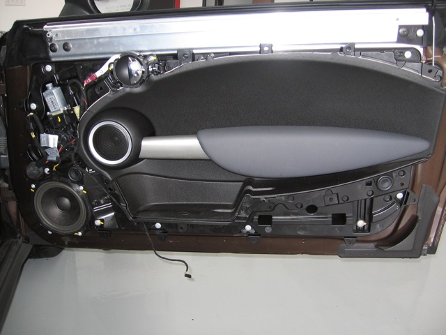

Hey Guys,
This is my first official post. I've been lurking since I picked up my 08 Clubman S last May. I love the car, but was less than happy with the factory sound system (I had the standard system not the Harmon Kardon). Anyway, I poured over all of the posts pertaining to improving the sound system. Everything from the wiring harness rewire trick to a full replacement of everything except the head unit. I wanted better sound but I was definitely intimidated by a lack of experience with stereo installation and honestly I did NOT want to screw anything up on my beautiful car. I finally decided to look around on City Search and Yelp for some reputible stereo installers. My thinking was that I would see what they had to recommend, compare the price to what I was considering doing on my own and go from there. I searched and found a guy in my area who was consistently given 5 star ratings. To say I lucked out would be a major understatement. The guy was professional, a perfectionist and he absolutely knew his stuff. I'm posting here to tell others what he came up with in the hope that it may help them on their journey.

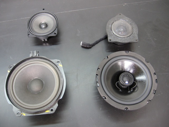

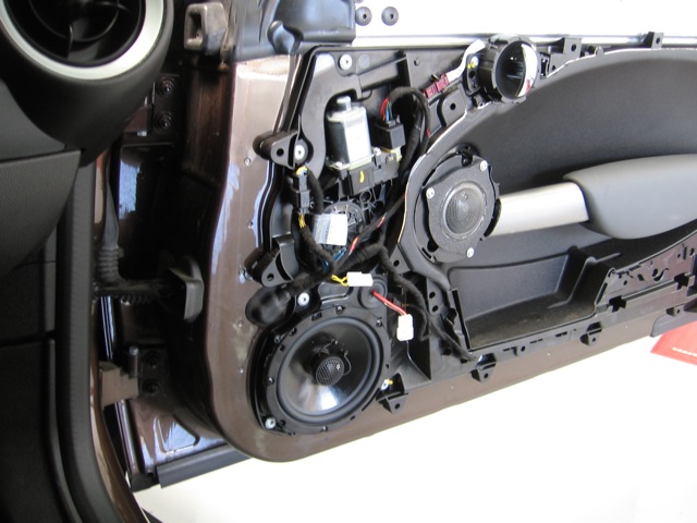

He initially proposed replacing the front 6.5" speakers with CDT CL-6EX speakers. These speakers combine a midrange and a tweeter into one speaker so he proposed CDT ES-02 2" Extended range mid tweeter for the 3" port. He built an inclosure with dampening for the mid tweeter.
The effect is remarkable. It almost seems like there is a stage on my dashboard. He initially proposed putting an amp in the spare tire area and possibly replace the rear speakers with subwoofers but the quote was a little more than I wanted to spend. We decided to go with a 2 phase approach with the speaker replacement being phase 1 and the amp and possibly the subs being phase 2. I'm attaching photographs of the process in the hope that it might help someone else whose going to do this on their own.
Cheers,
Mark
Attached Thumbnails My Sound Sytem Upgrade Story-mini-stereo-install-before.jpg   My Sound Sytem Upgrade Story-mini-stereo-install-before2.jpg   My Sound Sytem Upgrade Story-speakers-cds-on-right.jpg

My Sound System Upgrade Story (After Pics)
Here are the rest of the pics. I didn't realize that there was a 3 pic limit (I told you I was new ).
Mark
A special thanks to schatzy62 (Swiss Miss) for his numerous posts. I believe we have the same car (I cant really say for sure, I haven't decoded all of the acronyms and abbreviations you frequent posters use) and his posts have been a great source of information and inspiration
Attached Thumbnails My Sound Sytem Upgrade Story-mini-stereo-install-after.jpg   My Sound Sytem Upgrade Story-mini-stereo-install-after2.jpg   My Sound Sytem Upgrade Story-mini-stereo-install-after3.jpg
