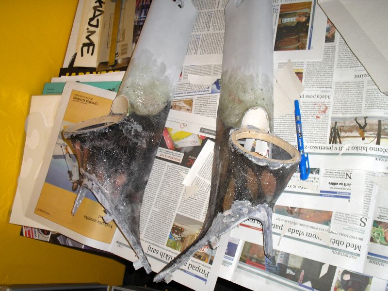

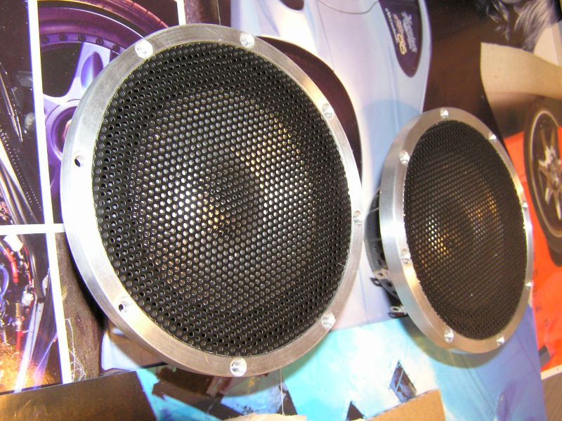

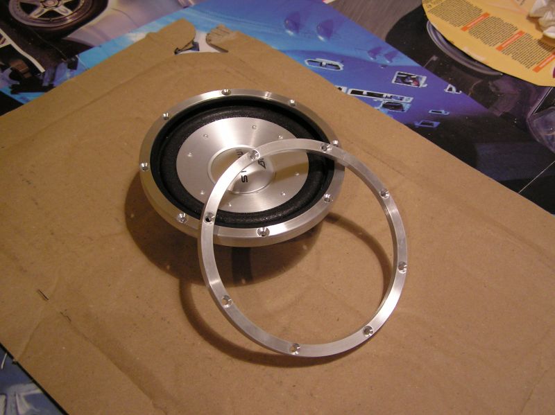

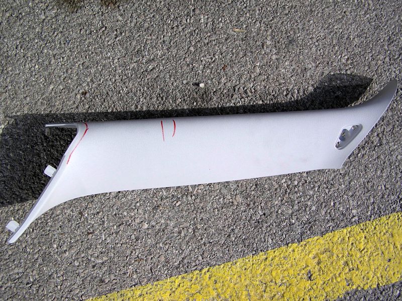

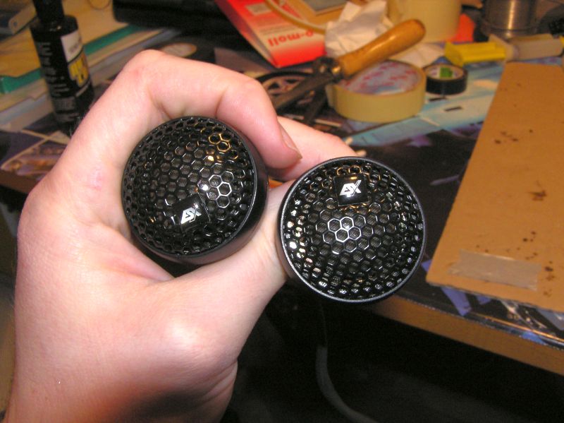

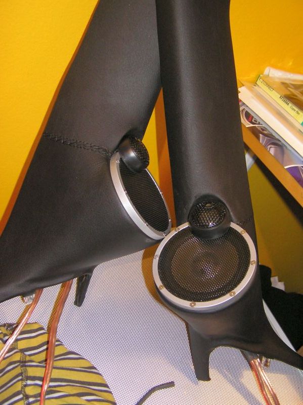

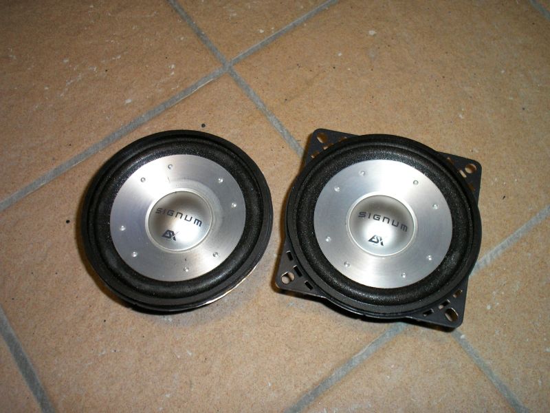

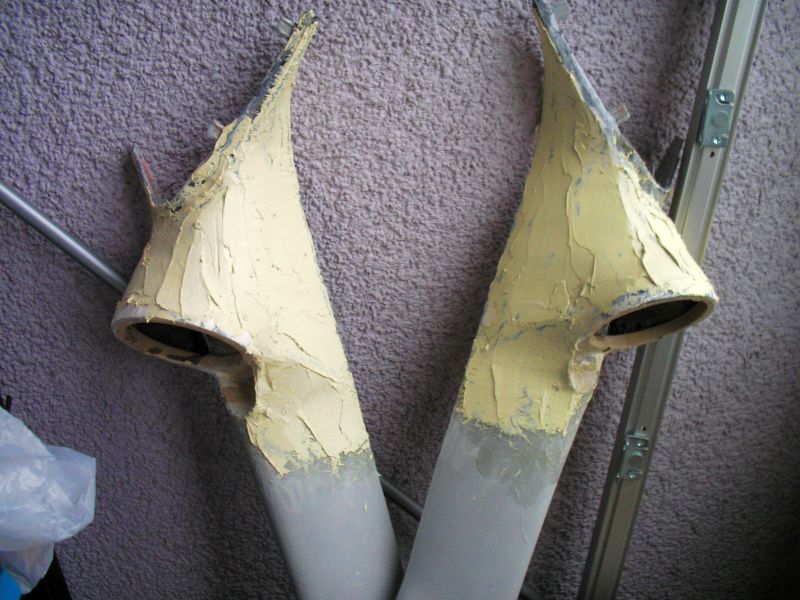

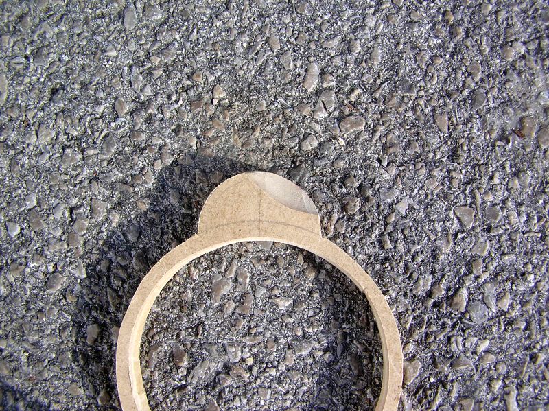

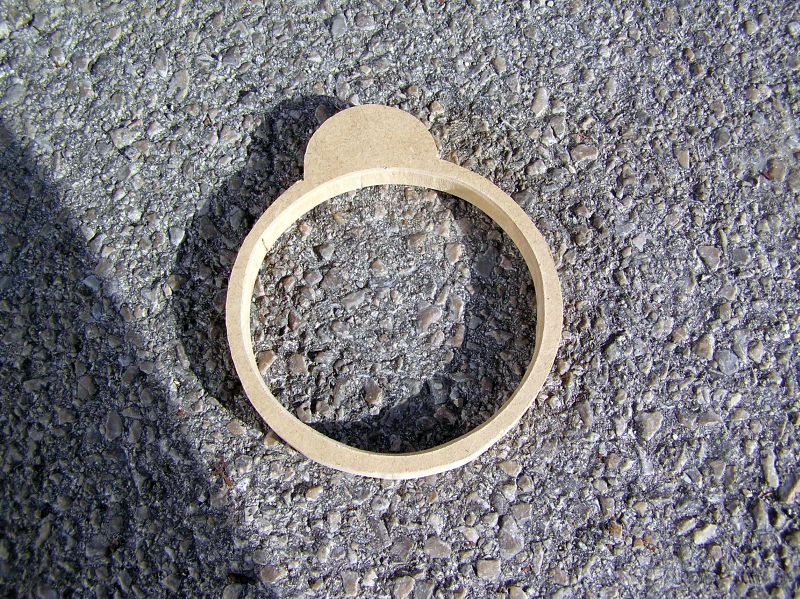

As the stage should be as high as possible, i've put 10cm speakers and tweeters in A-pillars:

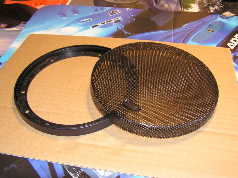

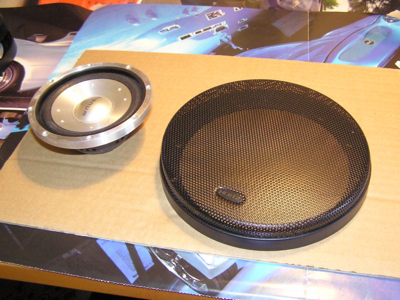

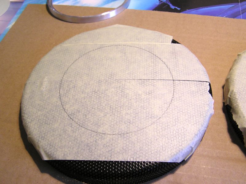

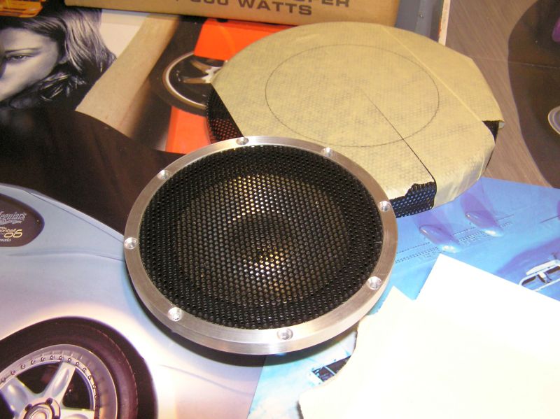

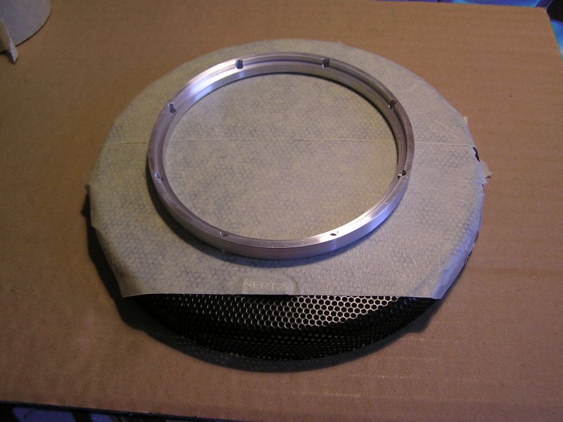

Custom protection of front speakers:

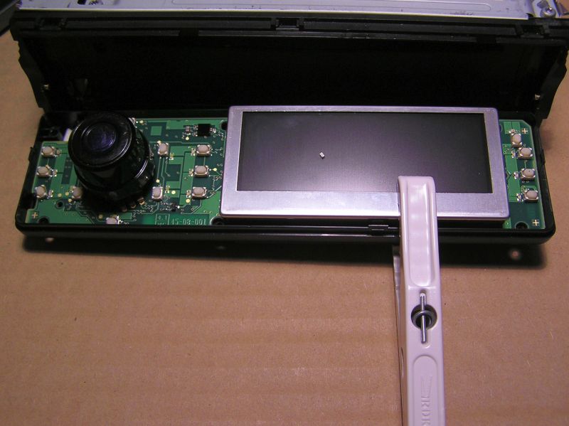

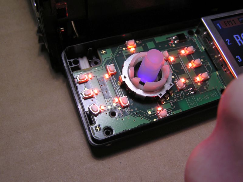

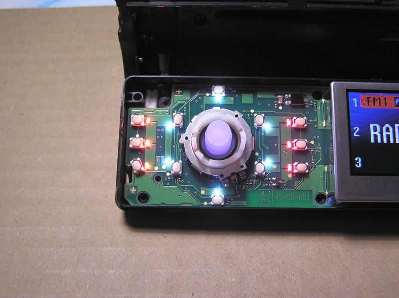

Here's changing illumination from white/red to orange:
This small thing on the radio display is the led.. 1,6X0,8mm
Partly done
All orange:

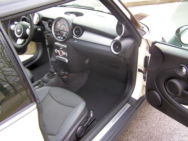

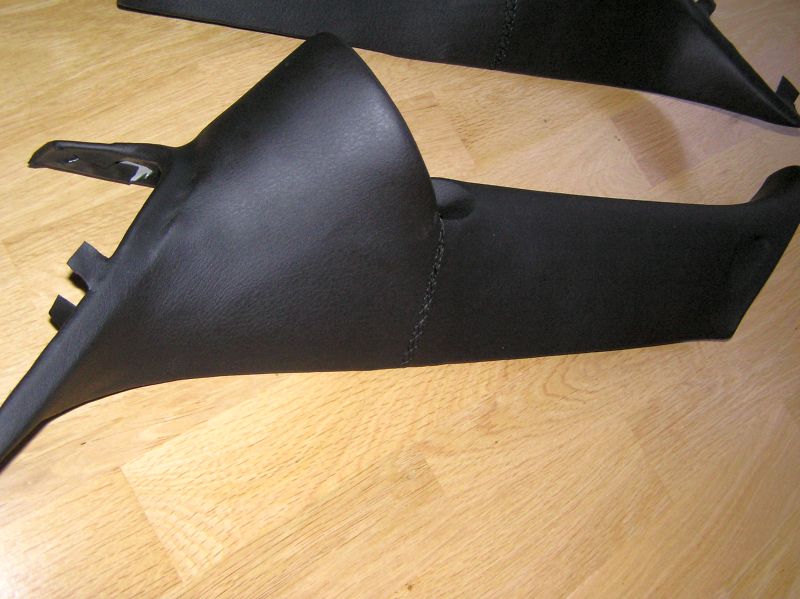

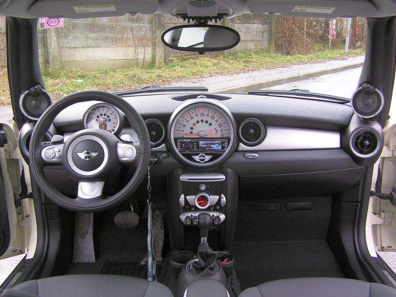

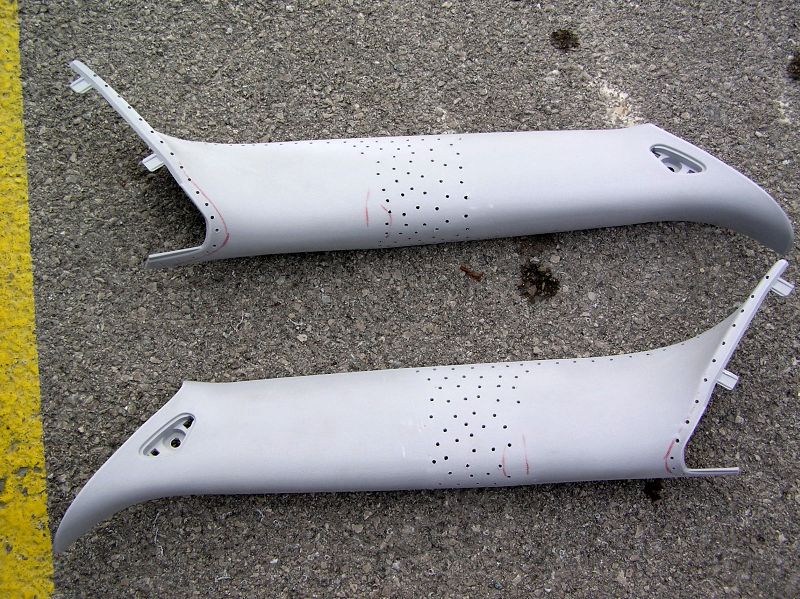

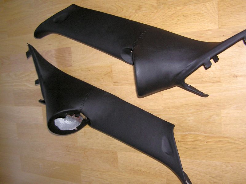

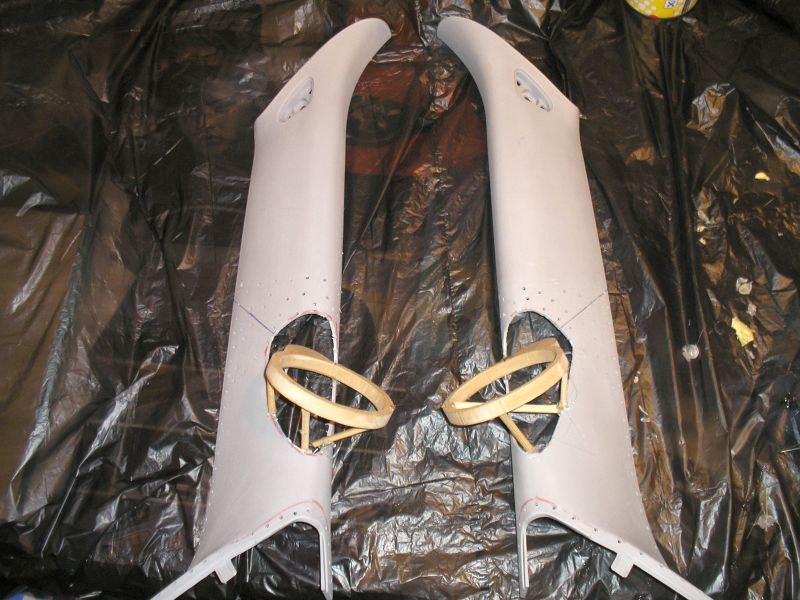

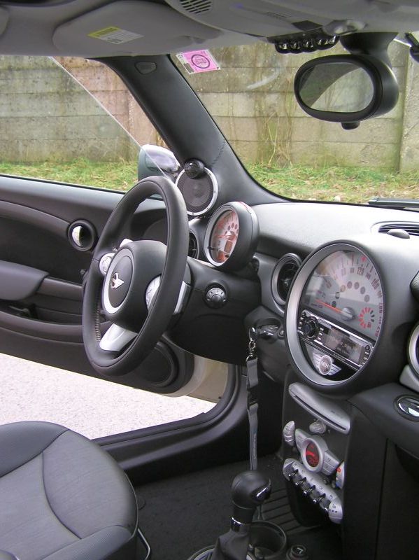

And my A pillars are done:
Because of the cables I had to flip the logo upside down:
done:

Old Jan 4, 2011 | 01:04 AM

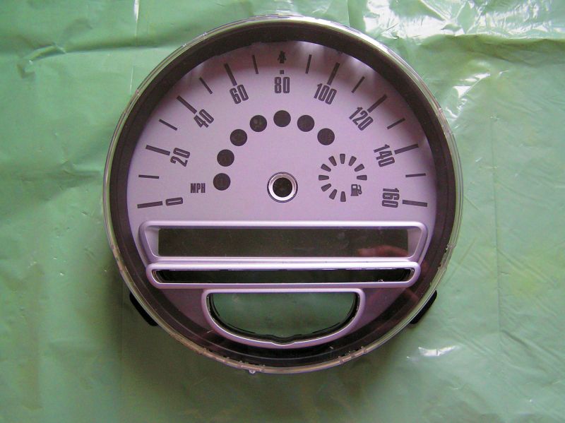

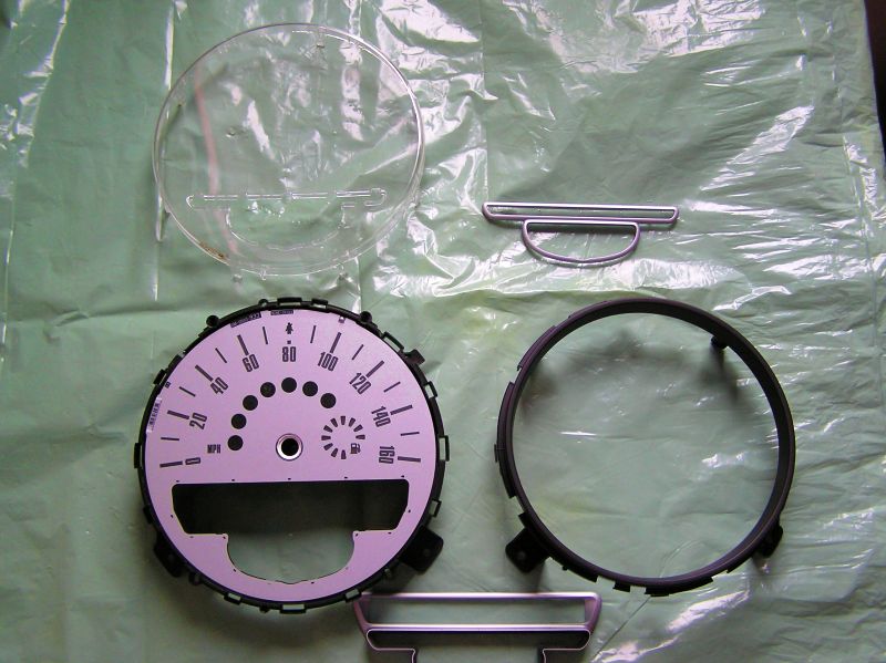

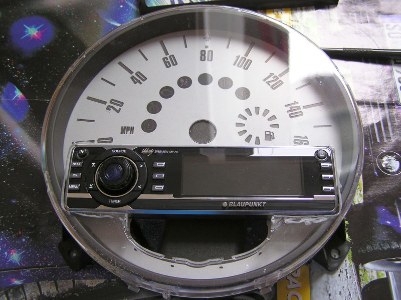

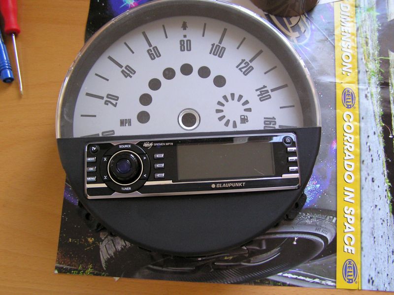

Front plate is integrated to the gauge:

A pillars:

Looks great. my only hang-up right now is that the speedo needle looks like it was put back on with a little error. Is that correct?
Old Jan 4, 2011 | 04:50 AM
perro's Avatar
perro
Joined: Sep 2010
Posts: 46
From: Slovenia/EU
Wow, great observation!
I had a problem, that the needle touched the radio plate with its back side at approx 80kmh. So I wanted to pull it off and modify it. It didnt go off. I tought I didn't do anything, but I did...
Another problem is, that previous owner changed the gauge background from MPH to KMH (the car was imported from US) - but they used 240 kmh scale instead of 260. It took me 3 months to notice that...
The bottom line is, the gauge is a lot more accurate than before...!

Here are some better pictures of the final look...

How hard was it to change out those tiny LED to orange? (I wanted to do something like this to a Sirius tuner, one time, which had the dreaded blue backlighting...but was afraid to attempt it!)
Imagine Dumbo (as adult) trying to have sex with Minnie Mouse...
Seriously, if you have some experience, it's not that hard... And offcourse the tools.
Thanks.

Changing out SMDs is not too bad as long as you have a steady hand and a good soldering iron. I replaced my instrument cluster LEDs on my last car with red and it turned out well. But those were a bit larger than those in Perro's head unit.

Yes, I did the same on my 2000 Celica.. but those were 3X5mm leds... These hrere are 0,8X1,6mm! :D
