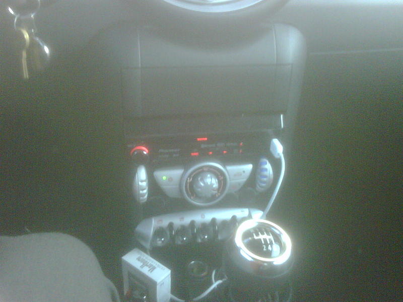

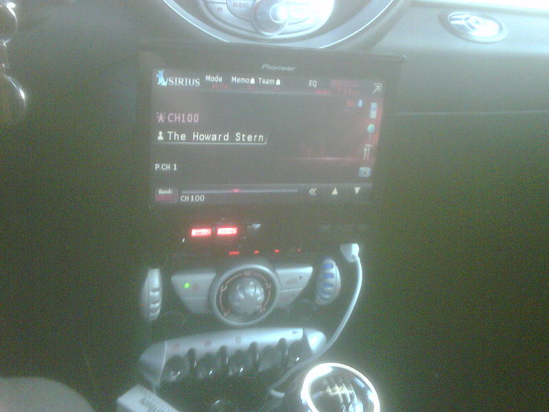

Forgot to take some pics last night when I got home
But I did take some this morning with my blackberry -- so please excuse the poor quality - but this will give you an idea of what the install looks like.
The ONLY thing I'm a little bummed about is I Pioneer headunit & add on NAV apparently has a software control that WILL NOT allow you to put in an address while driving!! As soon as I go over 5 mph, the address option is grayed out and I cannot do anything. Which I understand is a safety thing - but really inconvenient. Must research and find a hack for that one
And of course - I've lost usage of my cup holders. Since the Shokits dash kit actually moved the dash out by approx an inch and down about 2 inches, it makes it that you can't put anything in cup holders. So I'm now in search of some contraption so I can get a cup holder back
Here are the pics
Attached Thumbnails Aftermarket HeadUnit - I took the plunge-img00007-20100622-0712.jpg   Aftermarket HeadUnit - I took the plunge-img00011-20100622-0716.jpg
You shouldn't drink and drive
Sorry. Couldn't resist...
There was some contraption for mounting a cup holder on the upper right side of the dash... I can't remember for the life of me what it was called. I came across it in an article about legal autocross mods but I can't remember the d* name...
I'm not sure if it would work for you since the screen may interfere but it's worth a look...
