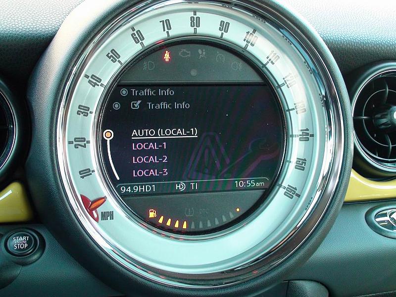

So, I took a pic of the Traffic setting screen, and on mine I see that I can select AUTO or 6 other LOCAL stations that broadcast RTTI.
What was interesting was, as soon as I started the Mini, I quickly went to the traffic settings screen, and it was all blank, as though it was searching the FM airwaves for channels that broadcast RTTI, then it fianlly populated the list.
