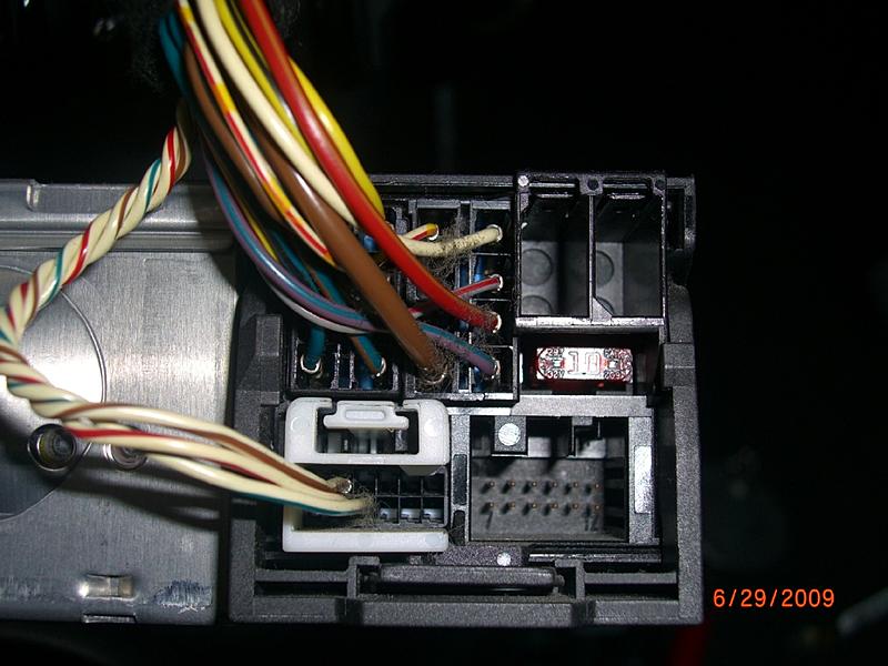

Looks like I have an empty jack!!!
So it's not a software issue with me, and I do have that spare jack.
Too bad I can't buy the jack locally while I have everything taken apart.
Thanks everyone for your help!

Congrats. If you know where the jack goes you will ahve no problem in reaching in a plugging it. I did it for the '02 I had, removed it and put it in the '03. the last time it took me all of 5 minutes to plug it in.
I mentioned I have the OEM cable and got it from Morristown Mini. It took about 2 days to get it and it cost about 40 bucks. The ones from aftermarket were much more expensive and offered no more.
I fished mine to my Euroshelf and out the jack in the cutout where a sxwitch would go. You may want to consider putting the end in the glovebox or wer you can put your ipod/mp3 player.
Again, congrats and always have faith.

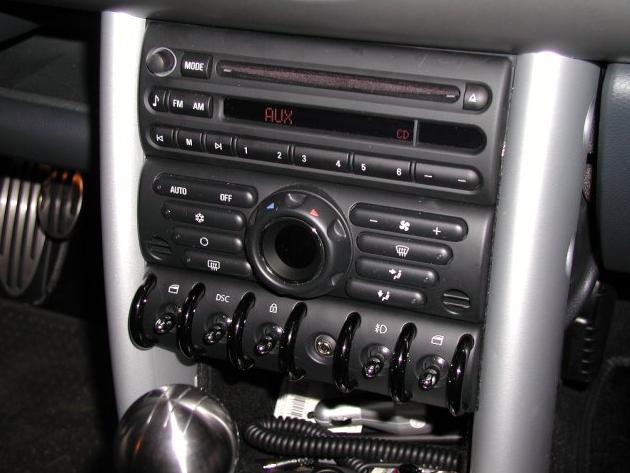

I'm gonna sit and wait for the mailman for the jack. In the meantime, I wanna figure out how I could make the jack fit in the toggle switch area.
I got the pic from another forum, but his DIY was not there...just the pic I attached.
