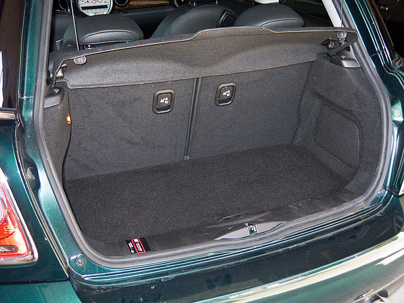

There have also been a few posts on this forum about stealth subwoofer installations. I had my installer add one of those also (in the boot). He used a combination fiberglass bottom to contour with the center recess in the boot and topped it of with MDF. The woofer is recessed into the box so the cover board can be mounted flush. The cover board uses an industrial type ventilation screen over the subwoofer hole (for support) and is "feathered" with cardboard between the board and the carpet so the edge of the screen can not be felt or seen. I used an ALpine 4.150 amp and used the space left under the amp for the Focal corssovers for the front speakers.
