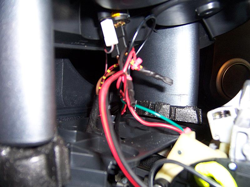

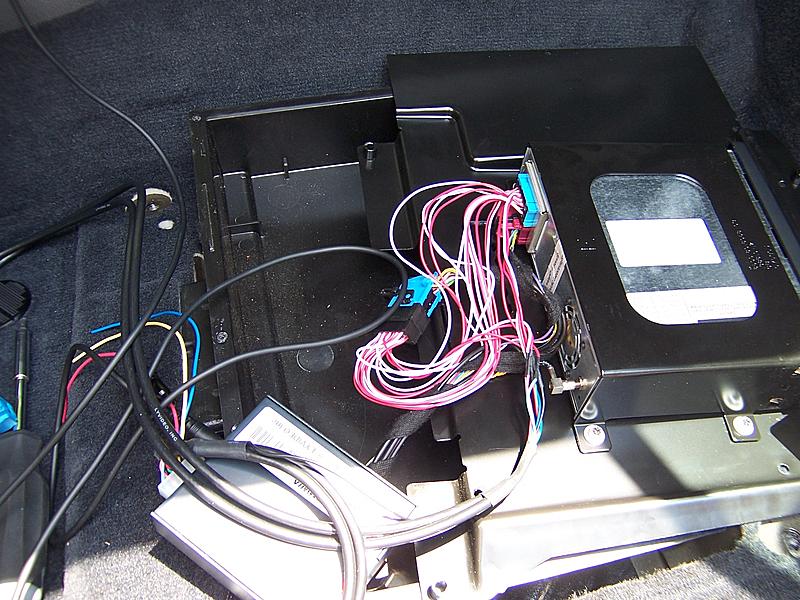

Pictures (not great) of the install!
This was WAY more involved than I expected! Thanks for all the help posted here! My advice would be to get a great electrician who also owns a Mini!

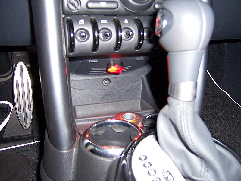

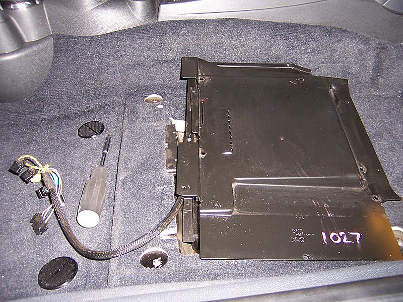

More pics of install
1).Removed and suspended center console, 2).wires into cigarette lighter, and 3).illuminated on/off switch

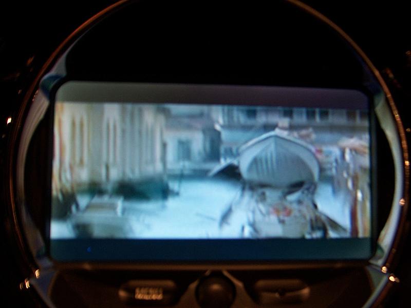

Final result!
Blurry photo, but decent actual screen image quality!
PS: The interface I went with was from here because the instructions seemed more straight-forward (however, there was still ALOT of trial and error): http://www.avelectronic.com/Navigati...Interface.html
