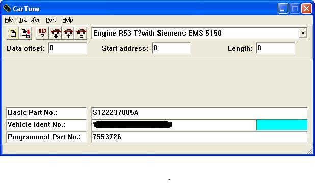

Pat (tradiuz) from MTH-USA and I are currently working on a problem I'm having with CarTune. I am attempting to read and download the data from my June 2005 build Cooper S convertible, and per the Info section at MTH-USA, it should be using the Siemens EMS 5150 ECU chip.
When I use CarTune to ID the chip, it detects the car as a "R53 T? with Siemens EMS 5150," as it probably should. However, the Start Address and Length are both zero, which leads to a "Length is 0!" error when I try to download the file. Please see the attached screenshots of CarTune for a visual idea of what I'm referring to.

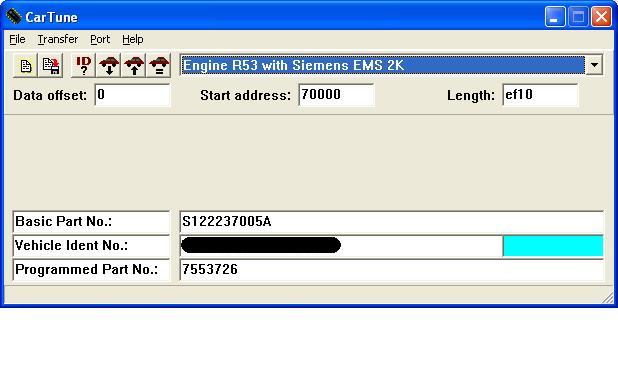

So I select the "R53 with Siemens EMS 2K" option from the pull-down menu, and have no trouble obtaining a valid Start Address and Length, which allows me to download the files. I sent these to Pat, who informs me that he always allows CarTune to automatically identify the chip, since it is never inaccurate. I take all the precautions to ensure that my Sensolutions MONO-USB cable is well-seated in the OBDII connector, and that all extraneous programs/processes on my notebook running WinXP are stopped, with no progress.
This is not my first experience with MTH chiptuning - I had MTH back when Franz was tuning files for just the price of CarTune on my older Cooper, and I never encountered anything like this. I am hoping that someone with CarTune experience (perhaps Volker?) can be of assistance with this one. Is this a case of an improper identification by CarTune, and I can procced with having the files identified as from the Siemens EMS 2K tuned and uploaded? Or will that be detrimental to my Mini? Is there something that I've neglected to do that caused the improper ID? Thanks in advance!
Attached Thumbnails CarTune Vehicle ID Problem-cartune03.jpg   CarTune Vehicle ID Problem-cartune04.jpg
the second pic looks correct.. i got that error with the with wrong com port.. try a different com port and be sure to change the com porrt on catune..

I tried two different USB ports, one of which gave me COM4 and another COM5, with the same results. Even restarted CarTune after I changed the COM port within the program to match that of the cable to ensure that the setting was remembered by the program. I suppose I could try adjusting the COM port manually (COM1-COM3), and see if that makes a difference. Thanks for the suggestion!

I tried setting the COM port to 1 and 2, both with no success.
I've also tried manually inputting the Start Address and Length as 70000 and ef10 respectively to download the file with Siemens EMS 5150 selected, and that causes the error "Car electronics not supported!" pop up.
