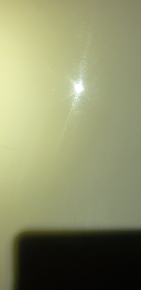

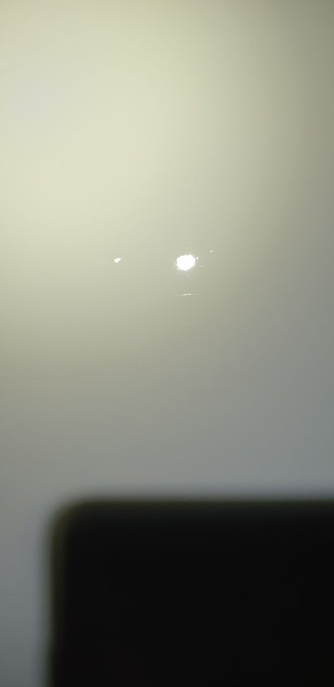

Did a test spot last night on the paint
Not a bad improvement.
Before:
After:
