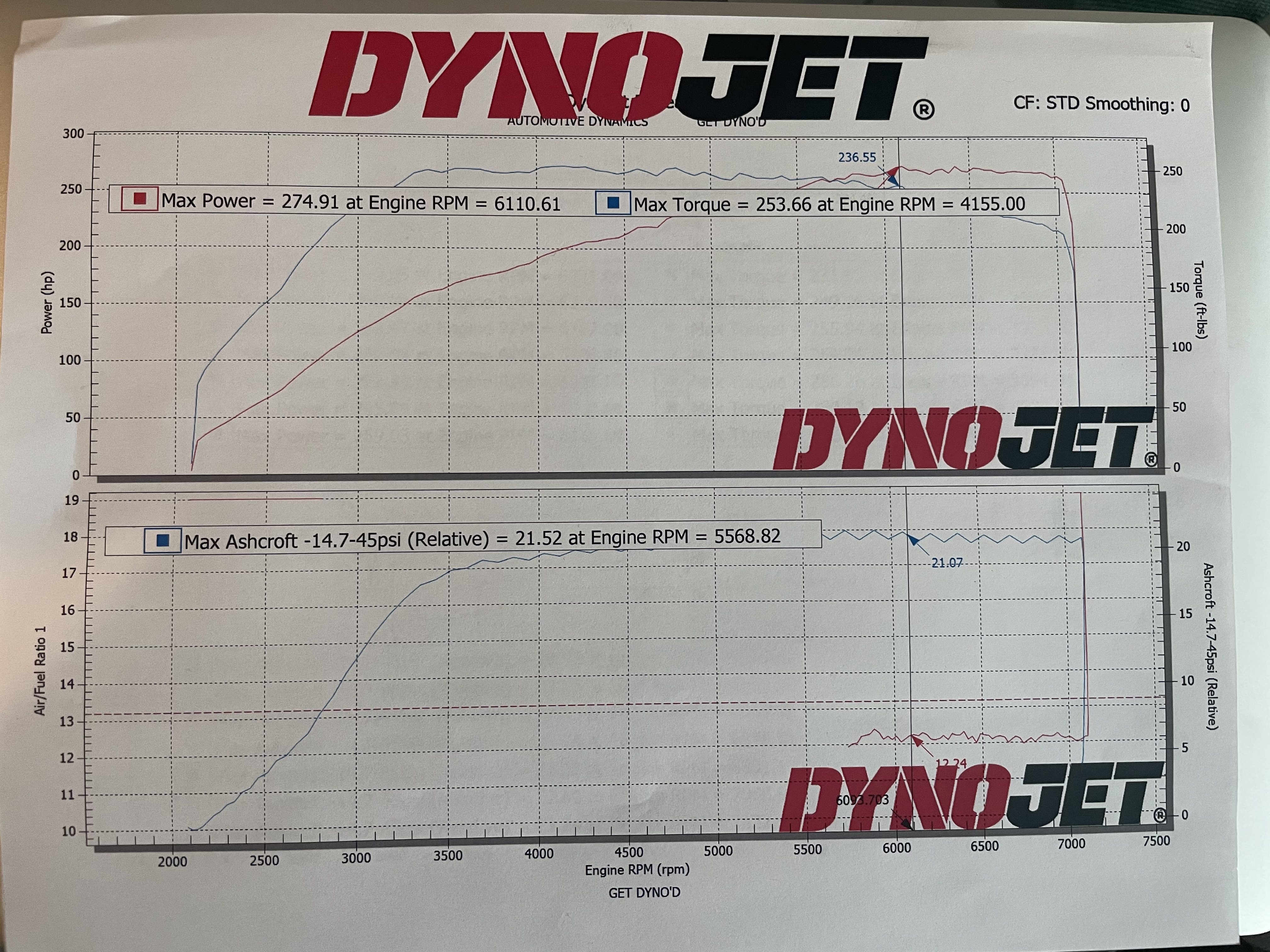

Well latest dyno 275whp at 21psi by accident. I had it set for more duty but boost by gear doesn’t work on the dyno 😂
Only water injection. No meth because of the rules I race in.
