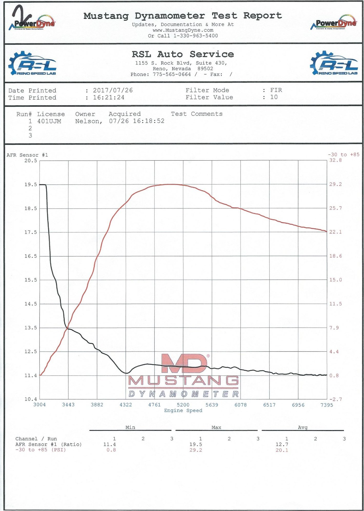

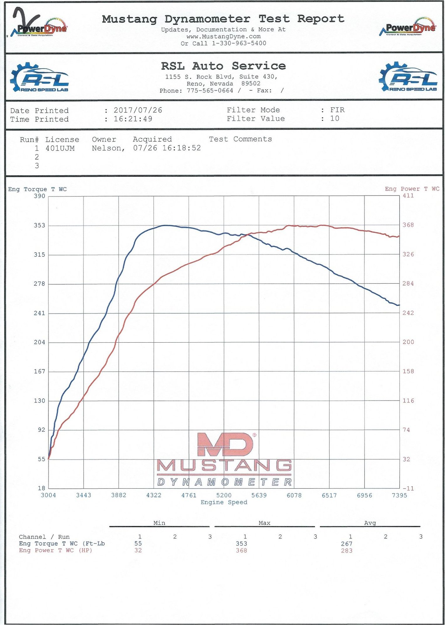

Tight is an understatement! Definite hard contact during hard acceleration and the engine is torquing (front end lifting). But I don't really notice the added vibration due to the adrenaline rush and concentration on fighting torque steer. Drives the spouse crazy tho!
The 3" cold air pipe is due to the turbo inlet size, I only reduced it to 2 ¾" for the MAF --- the "weak link" in plumbing diameter.
Last dyno ---
