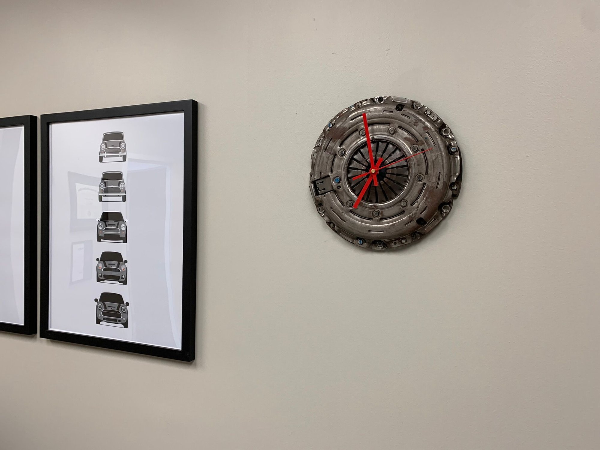

I suggest a proper memorializing is in order :

Njaremka, afraid I'm too lazy to clean the dead one up, put it back together, then find a place to hang it. Besides, a 20+ lb wall hanging would be too risky in my garage. Gotta admit tho, yours looks pretty good on the wall.

It makes for a cool conversation piece, if nothing else. I only used the pressure plate, and used hot glue to stick the clock mechanism tot he back side.
