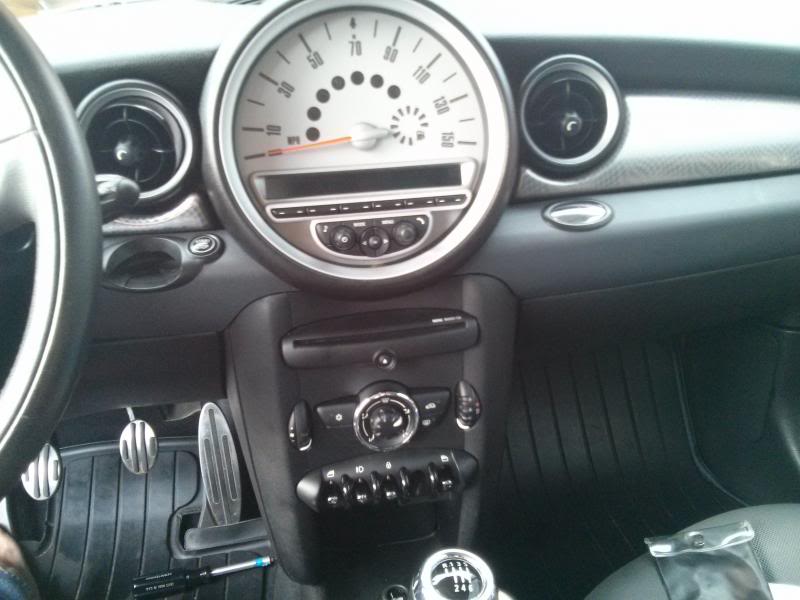

Ok...it is possible. All plug and play. You just need the radio, cd player and bezel from an 11+ R56. My R56 just has the base radio and found a unit that came with the h/k amp (which I didn't use) but the head unit works no problem. The new unit has HD radio working flawlessly. It comes with the USB so all I need is the wire from the USB to the back of the unit for it to be functional I guess. Bluetooth is working flawlessly also. My phone connects no problem but I still need a microphone for me to be able to use it. It also has Sirius enabled but I don't know what else I would need for satellite radio to work. If anyone wants to chime in and help me get the rest of the stuff working, I would really appreciate it. Thanks!!!
Here are few picks of my retrofit...

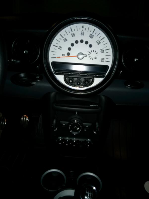

Here are a few of the finished pics with the 160mph speedo in with the black spray painted trim.
