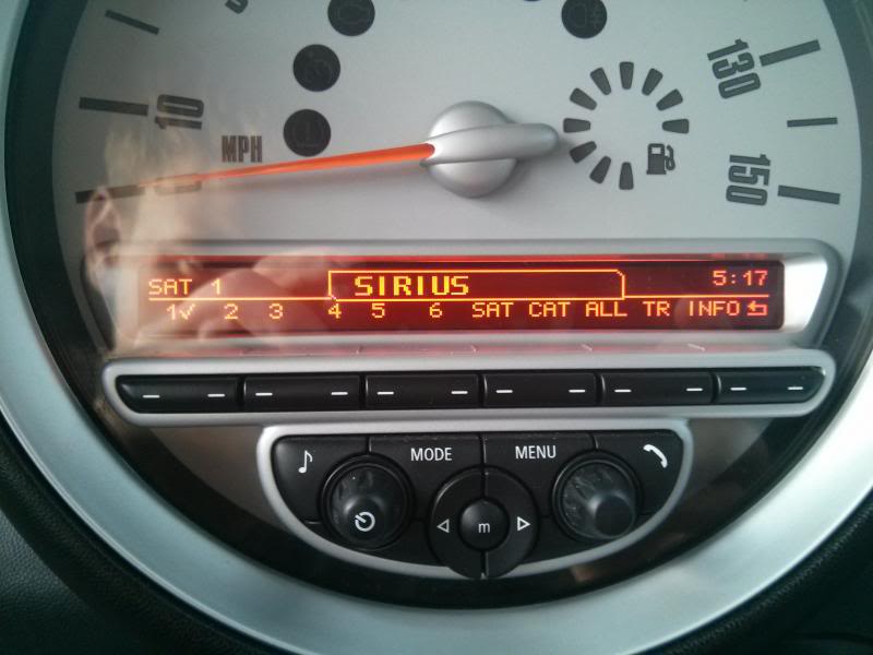

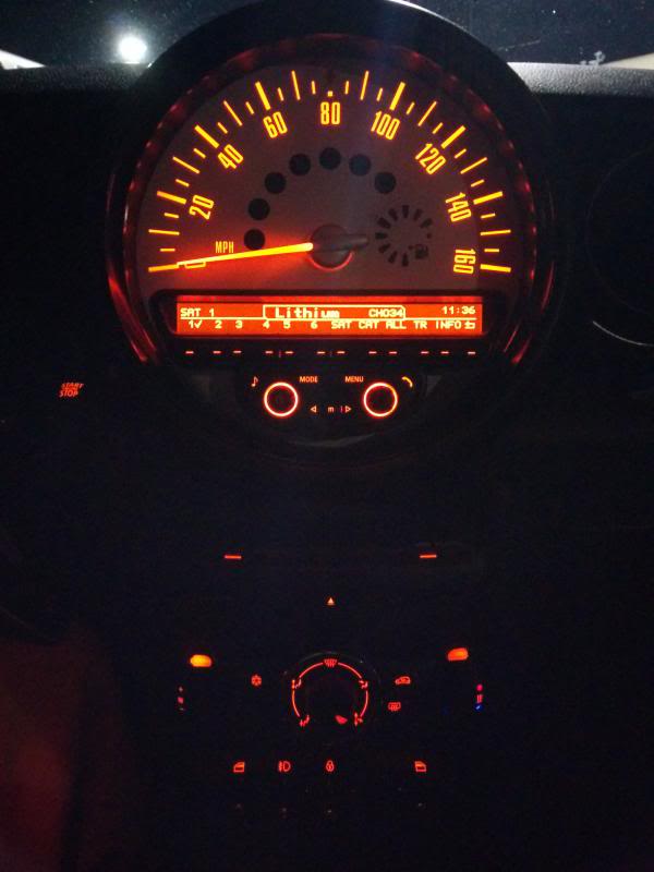

Here are a few of the finished pics with the 160mph speedo in with the black spray painted trim.

I still have a few issues with satellite and I still haven't figured out how to get the bluetooth microphone to work so there are still a few issues to be ironed out.
