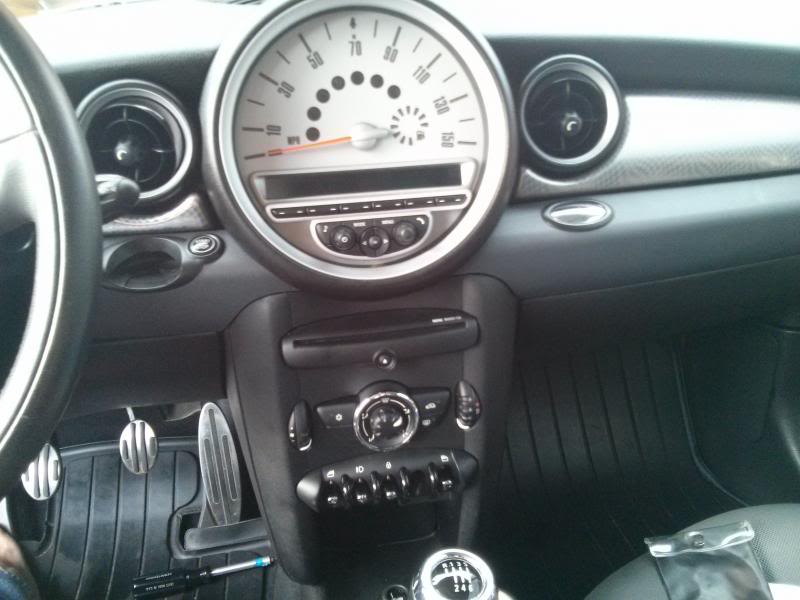

Anyway, yes I wanted to upgrade the center stack steering wheel controls and airbag to the blacked out look. I don't fee like I spent a whole lot of money since these were out of a salvaged vehicle.
While the new radio has a very similar plug layout it doesn't have the digital audio that my old radio had and along with that probably the input for the MIC. I thought my old radio might have had a digital optical input for H/K equipped radios.
I wonder if any of those 2011 models came equipped with any digital audio inputs on the back? So I can plug and chug. The research continues.

Ok...it is possible. All plug and play. You just need the radio, cd player and bezel from an 11+ R56. My R56 just has the base radio and found a unit that came with the h/k amp (which I didn't use) but the head unit works no problem. The new unit has HD radio working flawlessly. It comes with the USB so all I need is the wire from the USB to the back of the unit for it to be functional I guess. Bluetooth is working flawlessly also. My phone connects no problem but I still need a microphone for me to be able to use it. It also has Sirius enabled but I don't know what else I would need for satellite radio to work. If anyone wants to chime in and help me get the rest of the stuff working, I would really appreciate it. Thanks!!!
Here are few picks of my retrofit...

Did you get the Sat tweaked and working correctly? I just did this conversion for the second time ('09justa w/ '13justa parts and '07S w/ '11S parts) the second project the '07S has a factory enabled Sat. It works but it errors out and disappears when the key is switched on. I'm thinking I might have to match the vin to project car...?

How did you change the dials to black? Is it possible to get a black unit and take off the covers and switch covers rather than swap over, which i hear is not possible. due to wiring changes.
