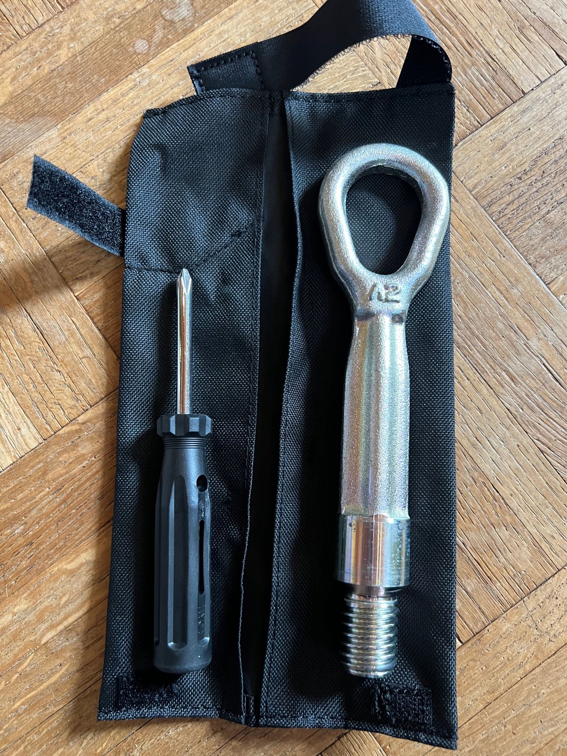

As per your request, below is the video. It took almost 14 turns to screw in the tow hook. Additionally, the tool kit consist of two items: the tow hook and a Philips screwdriver (see pic below)

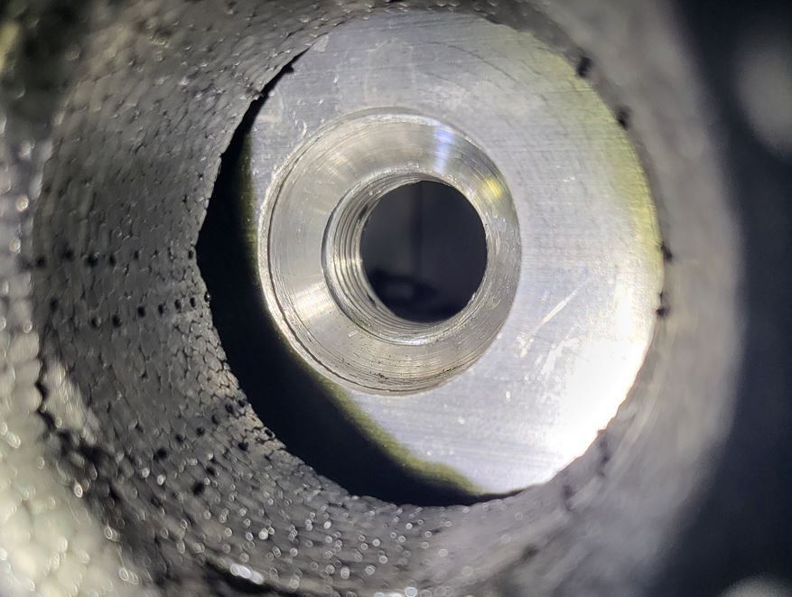

Does your tow hook look resemble mine (like in the photo that I posted)? Try screwing your tow hook in the back bumper and see if it works there.

Yes, same tow pin (pictured).
Screwed into the rear receiver without issue.
It looks like I was mistaken about the angle not being straight or the holes not lining up correctly. At this point, it looks like the only issue is that the threads need the be chased out because I can only get 1 thread in there. Barely a full turn. That wouldn’t be safe for recovery or flat bed loading. Gonna take it real slow with a big screwdriver and some thin oil lube maybe a quarter turn at a time. What do you think?
I see there’s room for a lug nut key in this pouch. Did you get locking lug nuts @michaelo ? Most people don’t want those anyway.

I went out and took a close up picture of the threads, can you do the same and see if it matches mine? Maybe yours has been somehow painted and the threads are clogged with paint (or dirt).

Update on the tow pin. I got it in! It took lots of patience and elbow grease but I used a big screw driver to help turn the tow pin about a half turn at a time back and forth/ in and out, wipe the threads clean of metal shavings, more oil, back and forth until I could screw it in all the way by hand. I’m not able to do it with 2 fingers, more like 2 hands but it’s finally the way it’s supposed to be. Thanks for the help.
