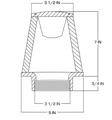

I was contemplating foam, and specifically ITG,
but keep reading stories of degradation and crumbling foam,
so will likely avoid.
I like the idea that they may flow better, but short lifespan is a major compromise given the cost.
I'm bummed out that Amsoil discontinued their air filters --- previous owner of my car had fitted a 3570 it seemed fine but the color was faded looking,
I replaced with a new one so it should last a good while, but in the meantime I've looked into what I want to go with next.
Using the Amsoil chart as a baseline for fitment...
...but I'm sure there's a little wiggle room there?
