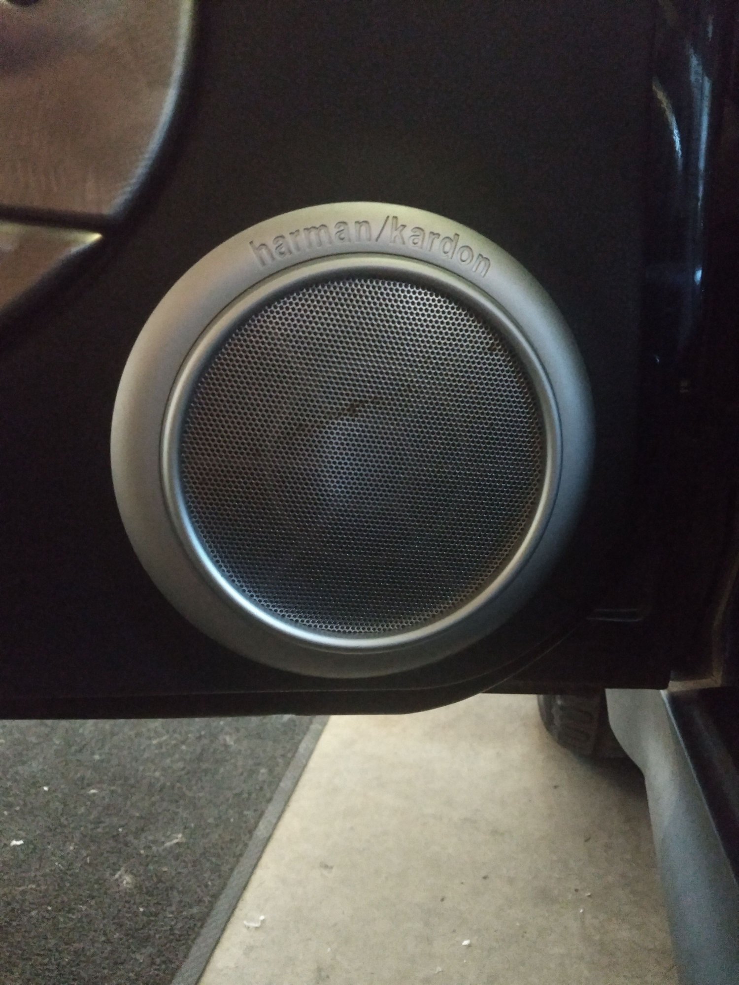

Hi guys, new here, just bought an 04 jcw, taking care of some maintenance items at the moment and I noticed that is the spot behind rear passenger seat, there’s no amp. Google image search says the head unit is hk and at least the speaker grills say hk. Now I’m a half decent mechanic and I would suspect that there would be no sound if the amp was missing. Do the non hk radios look the same as hk?

His first post confirms it says H/K on the front speaker grilles. Sounds like prior owner could have replaced the door cards.

Yes, the speaker grills say HK. Yes it is a hard top. No there is no amp in the rh compartment behind the seats. I’m going with the door panels were changed. Should say something on the back of the speakers?
Yes, see the attached example. It says “Harmon Kardon” on a sticker. Also, if you go into the sound settings on the head unit, once you scroll past bass/treble/fader/balance then you reach sound profiles. If you can scroll through the profiles (including one called “H/K MINI” then you have the H/K head unit.

Yep, that part number is the standard front speaker. Looks like it was replacement door cards.
