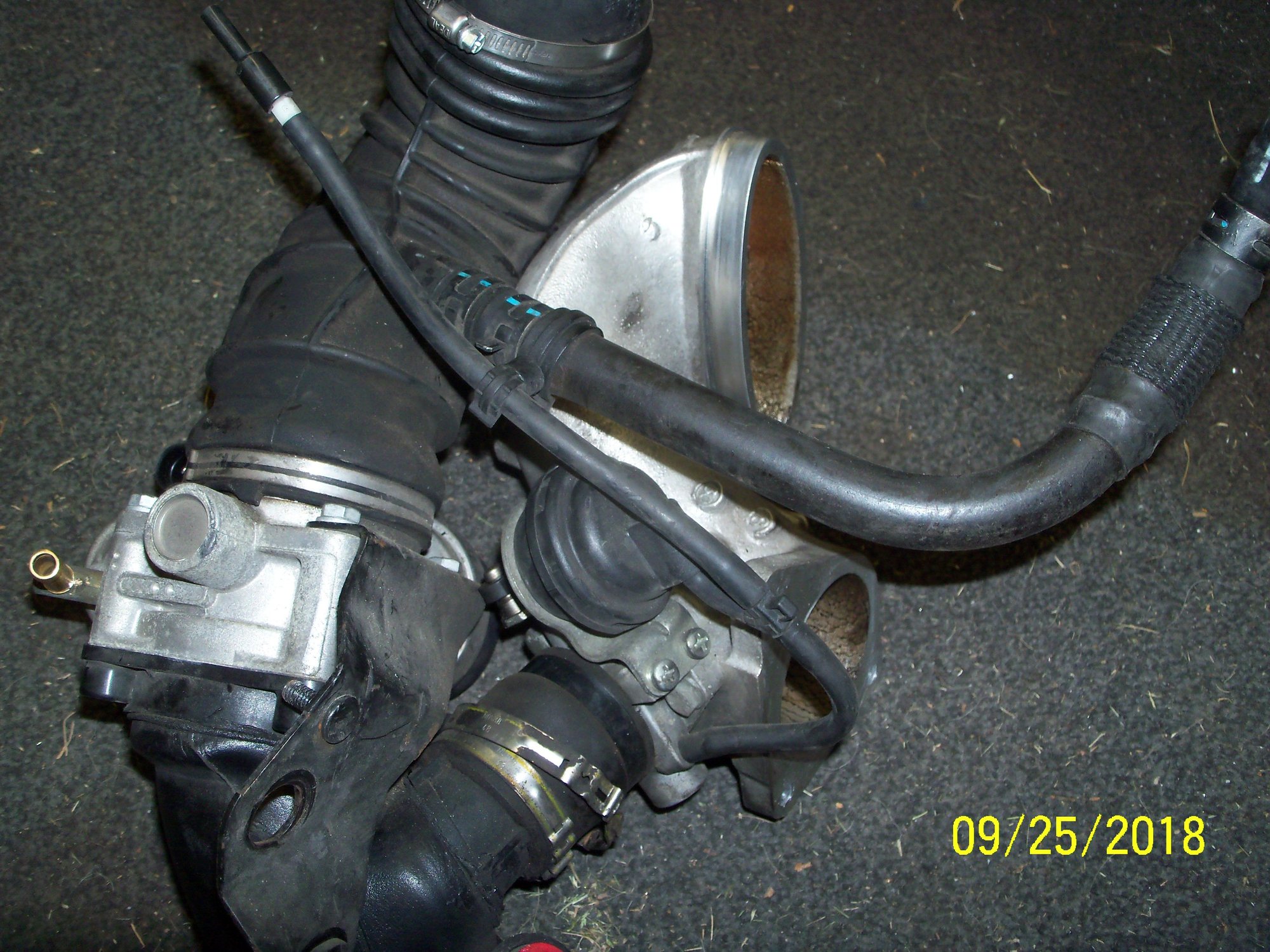

Where does this vacuum line pigtail go?
Seems to be specific to the JCW engine, my 04 R53 MCS does not have this extension on it
I'm at a standstill on finishing getting the engine installed until I know where this goes or what it does

JCW airbox vacuum actuator??

Yea, I think your right, I can't think of anything else it could be for.....and it looks factory.......I just don't remember disconnecting this from anything......I'll just plug it off for now
Thanks.....

Its very possible that you didn’t disconnect that pigtail. I know some people preferred to have the vacuum operated flap always open for more supercharger whine. If I remember correctly, some would zip tie the flap open and disconnect the vacuum line....to keep it open...

That line was broken when I bought my car, I removed the entire flap assembly from the airbox and capped the BPV.

like I posted in your other thread it is for the vacuum actuator on the JCW intake.
Since you aren't using the JCW intake you should just remove the T at the bypass valve and connect the short hose back to the bypass valve as you don't need this extra vac hose laying around being something that could get a leak and would cause more issue later.

I understand what you are saying, but after tearing my other mini apart only to find out that there's no pigtail on that car, I think I'm just gonna cap the end off for now. That way the pigtail will still be accessible if and when I ever find a stock JCW air box that the car is supposed to have.
I wasted half of the day taking my other Mini apart and putting it back together
It's a big pain getting to the single vacuum line when everything is in the way.....let alone trying to put the "Y" fitting back in if need be

That's a good option if you want to have the JCW airbox hooked up as intended at some point. Many do a 'flapectomy" and keep the flap tied open, or remove it altogether. I removed the flap, vacuum canister, and the round actuator completely from the airbox. Since I added the airbox, my car never had the T at the bypass valve or the wiring tied to the ECU.
I've read the flap was only added to comply with noise restrictions and doesn't open until4,500 RPM's. As an almost useless excercise/mod, I'm thinking of installing the airbox as intended, but having manual overide switch for the flap, similar to the Gen 3 JCW sport exhaust valve.
