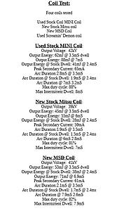

Here is MSD and Screaming Demon proof from a good friend that had them tested.
So because EVERYBODY asks about coils, I will post up some test information so its easily searchable when somebody posts up about the weaker than stock MSD coil soon.
As you can see the MSD is a UPGRADE over the stock Mitsu coil, but not over the stock MINI coil.
With a 3,5ms dwell time the stock coil will be right around its max duty cycle at 8000rpm using wasted spark like the stock system.
All of them will honestly light off a spark with a M45. Its the back feeding to the ECU you have to worry about with the non stock ones. They have fried many 1st Gen MINI OEM ECUs over the years but people don’t listen because they are Red and made by MSD (for a Dogde Neon) so they must be better.
Attached Thumbnails Value of JCW package on used Cooper S-460ee096-4b23-4823-a2af-fbb82e9d04b0.jpeg   Value of JCW package on used Cooper S-500fb60f-0109-4a98-9195-6f543f0b5939.jpeg

See the post right after yours, because I knew someone would ask for proof.

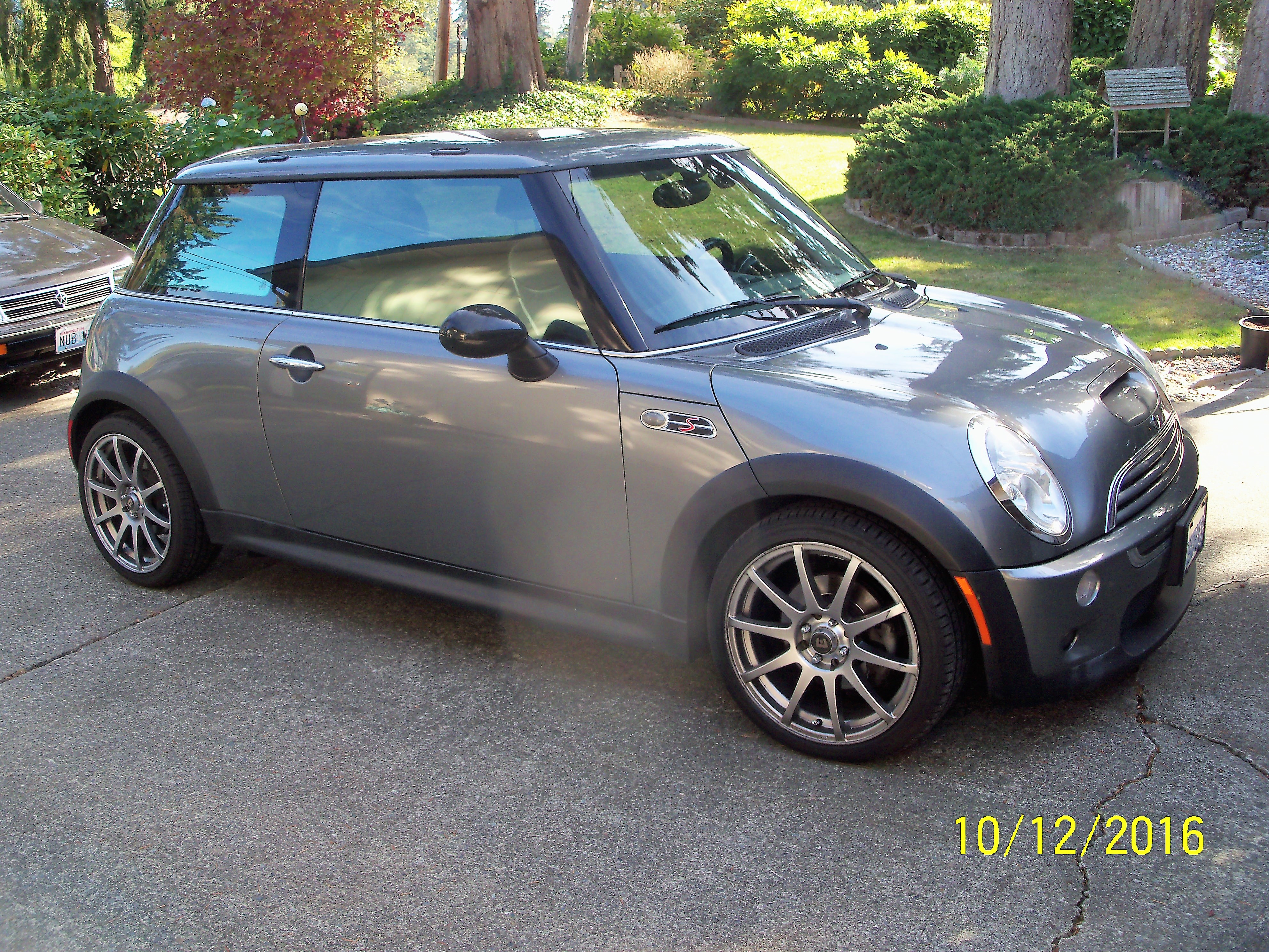

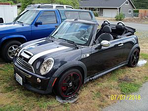

Hey Randy, I was reading yer post, looks like a decent car, but I would start a bit lower on the price.
I just picked up this '06 R52 MCS JCW a few days ago.....problem is that it doesn't run....which I'm working on getting it running as we speak.
I also have an '04 R53 MCS that I got a couple years ago.....
I'm down here by Federal Way area.....maybe we can get together sometime
Bryan
