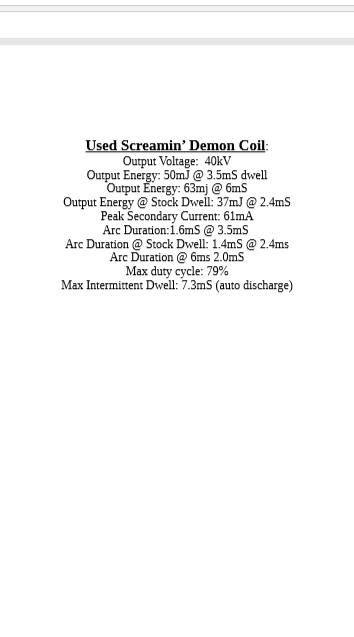

Originally Posted by Dave.O
Here is MSD and Screaming Demon proof from a good friend that had them tested.
So because EVERYBODY asks about coils, I will post up some test information so its easily searchable when somebody posts up about the weaker than stock MSD coil soon.
As you can see the MSD is a UPGRADE over the stock Mitsu coil, but not over the stock MINI coil.
With a 3,5ms dwell time the stock coil will be right around its max duty cycle at 8000rpm using wasted spark like the stock system.
All of them will honestly light off a spark with a M45. Its the back feeding to the ECU you have to worry about with the non stock ones. They have fried many 1st Gen MINI OEM ECUs over the years but people don’t listen because they are Red and made by MSD (for a Dogde Neon) so they must be better.
My question is this, who did the testing and what was the input voltage / amperage? Both of these things will affect coil output greatly.

There is a lot to a coil make-up than just a simple step up transformer. You have to take into account winding count, materials used, insulators, supply voltage, etc.
There are many things that can help get more spark energy to the plug, one of them is as you mentioned.
A quality spark plug wire with quality boots.
In Japan the big thing is voltage supply to coils, bump up the voltage, bump up the output. This is not dependent on the DME as they use different styles of ignition boxes and such to achieve the target input voltage and maintain it during hard use.
But I digress, my original idea behind this thread was to analyze the data that Dave.O had provided. The first question I asked would be the missing variable in the data. Without that information the data is inconclusive.

14v///amperage was what the coil pulled.. It is a 14v feed on a 20 amp fuse. He didn't give me the numbers for what the coil pulled on the amperage. The coils are ran off a Motec engine Sim 3. Wasted spark config.

Thank you for sharing this data.
Now the data all adds up.
I am curious why you haven't gone to a sequential ignition like the high hp Evo / SRT4 guys run?
