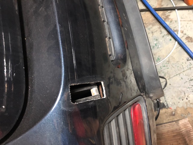

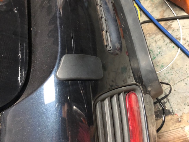

Also the car has these interesting cut outs in the rear bumper - any clue what these are for (some kind of removable rack?)?
