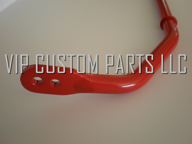

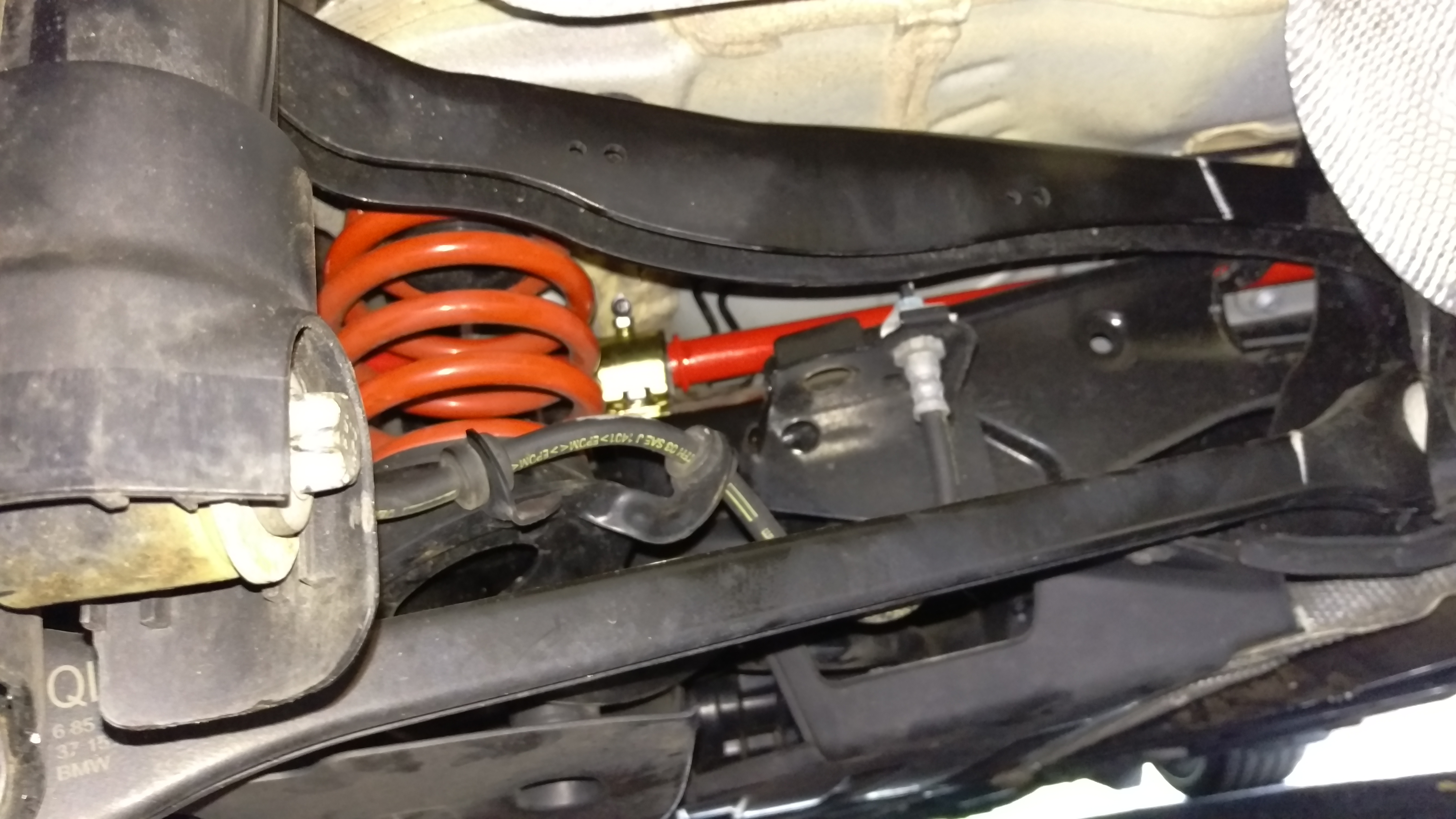

Although my JCW hatch with JCW Pro coilovers handeled well I still felt the back end lifting & unloading during hard cornering.
So i chose the VIP 23mm rear sway bar since it is the largest diameter out there.
The install is very time consuming . ~3 hrs. labor as u need to drop the entire rear sub frame to access the sway bar mounting points/bushings.
It also will require a rear alignment as well so this upgrade is a very expensive ordeal. $200.00 for VIP rear sway, $300.00 labor & $125.00 rear alignment on a Hunter machine.
But in the end the car is transformed. Night & day difference. I actually like driving it now compared to my Porsches. I fell the handling benifits out weigh the cost.

a rear sway bar is a very nice almost absolutely necessary mod.
Just wanted to correct one thing though about the VIP 23mm bar being the thickest. NM-Eng has a 25mm bar
$300 labor?! ouch. also you don't need to completely drop the rear subframe, just lower it a little bit. i was able to do the install on jack stands in less than two hours. no need for an alignment afterwards either (unless of course the rear subframe is completely taken off which I'm guessing whoever you went to did)

I believe the NM 25mm bar is hollow, and possibly the VIP 23mm bar is solid. If so the 23mm bar is quite a bit stiffer than a hollow 25mm bar. I had a 19mm solid bar on my 2007 MCS and it improved the understeer quite a bit. Mine cost $200 plus $100 in install by Way Motorworks in 2008. No links or alignment needed.
