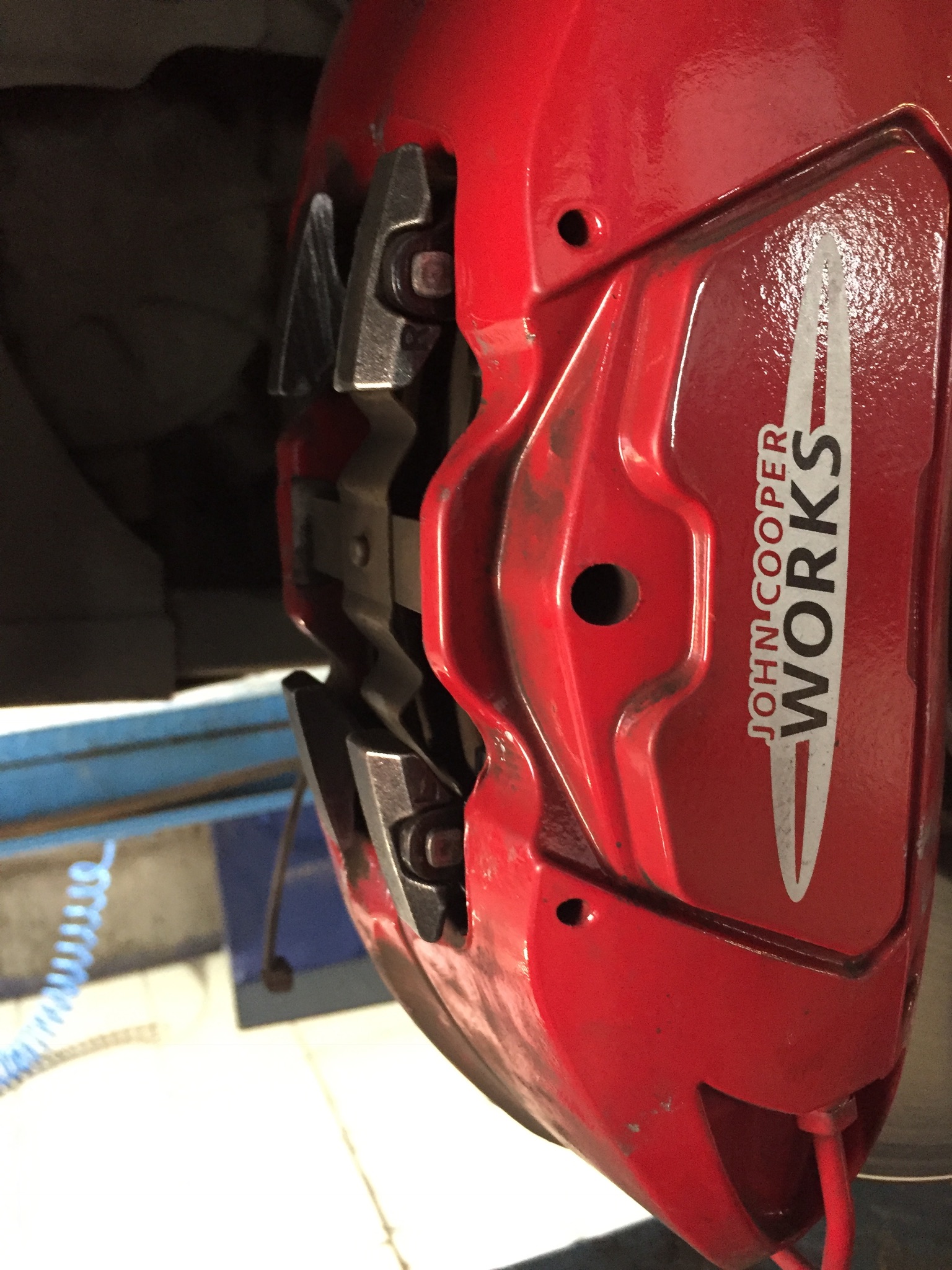

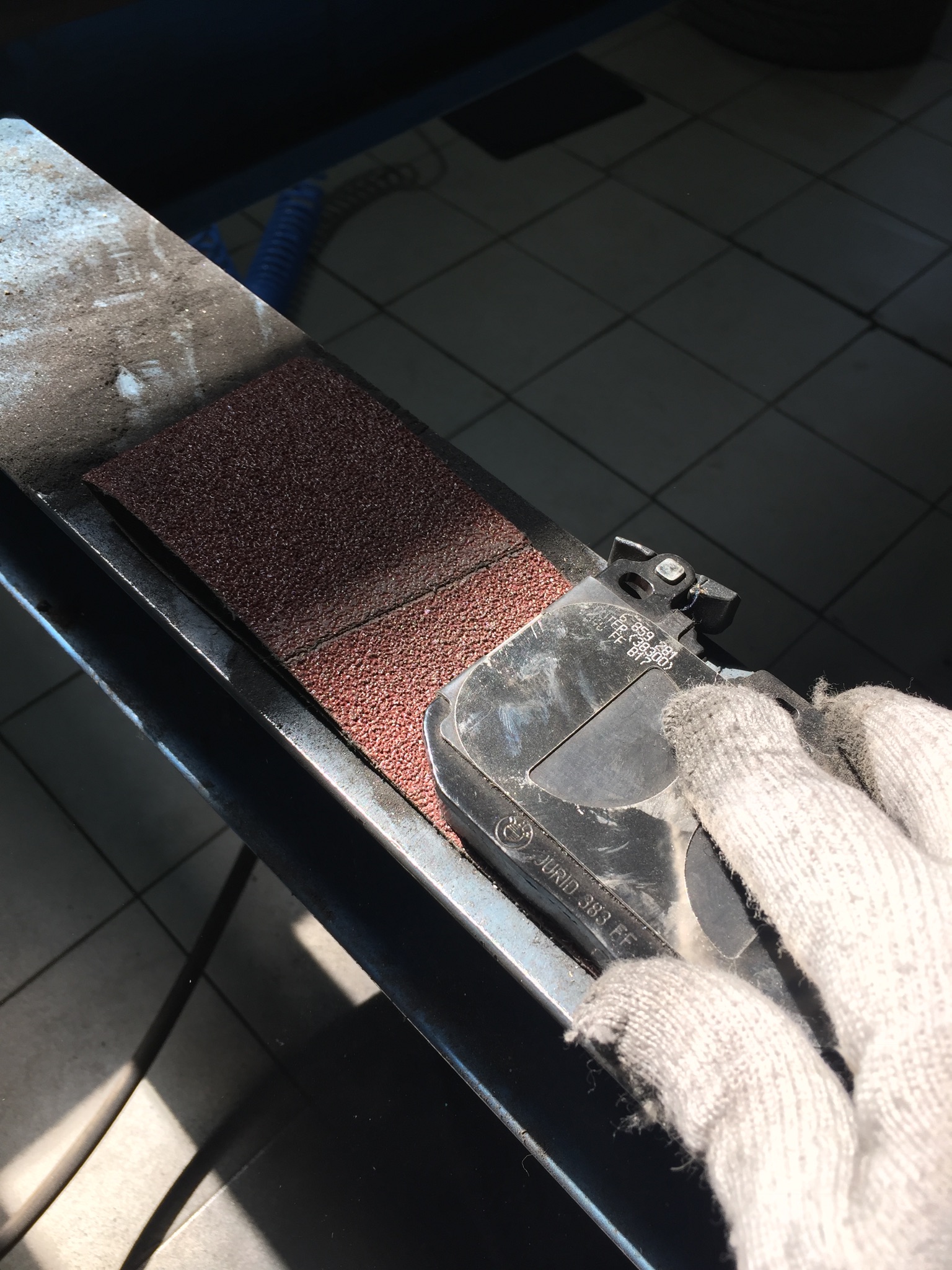

There is another 100$ option for the brake pads - Ferodo FCP 4872
Or any bmw pads for f30 with M performance brakes, but in that case you have to grind out 3mm of extra thickness to make them fit
Attached Thumbnails Need pad help for NEW Stoptech rotors, F56 JCW-img_0217.jpg   Need pad help for NEW Stoptech rotors, F56 JCW-img_0213.jpg
FCP4611 fit too, with the same trimming requirement. No need to break tabs off either. They're really killer pads on this car. I had a little bit of squeak below 5mph while coming to a stop under certain pedal pressures, but they've been quiet since. Nice grabby pad, and takes heat like a champ.
