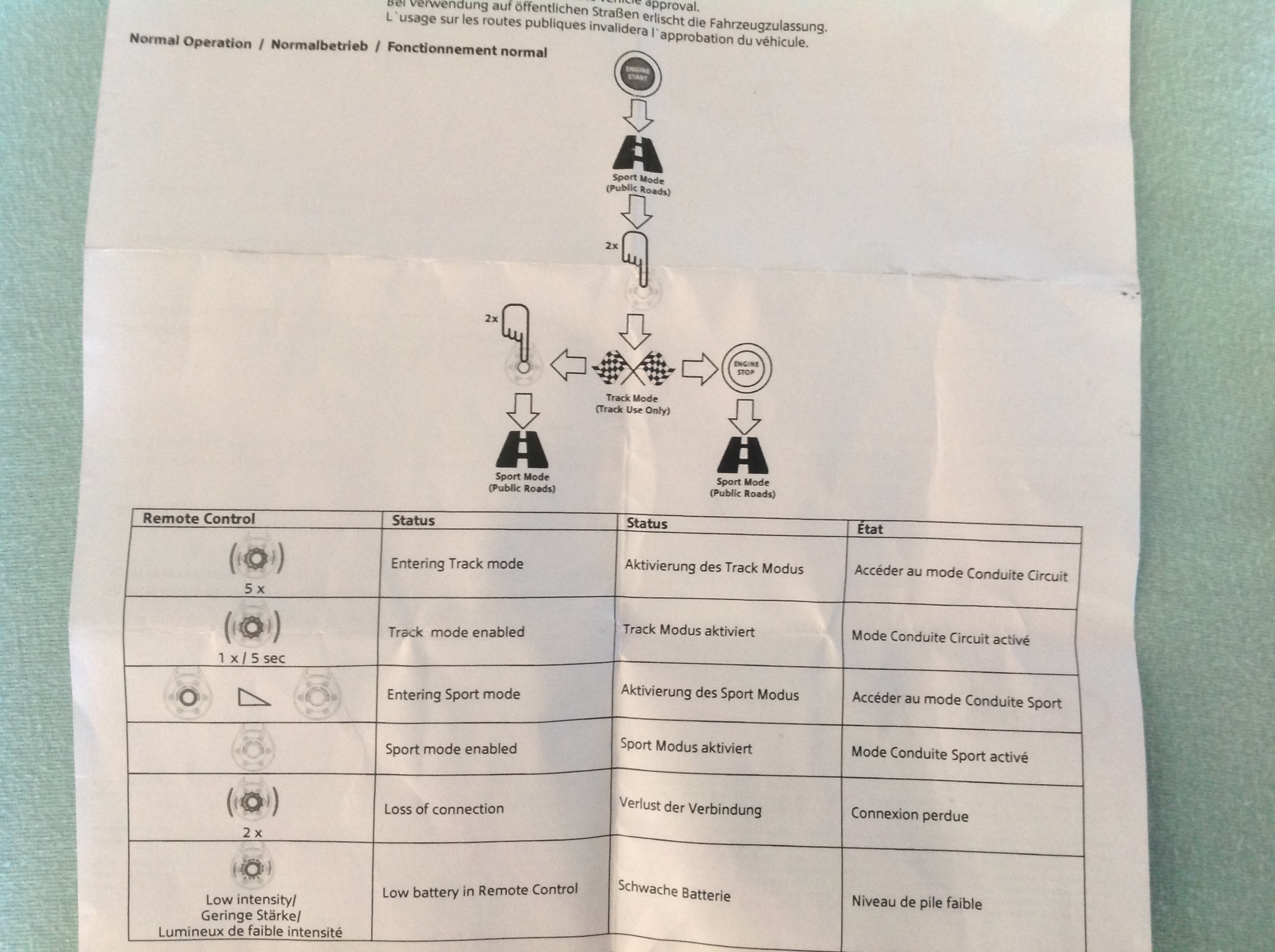

I understand the basic function with the remote but I also got this sheet with it. I am not sure what these functions are on the remote....anyone understands what these are? Especially the first two options x5 and 1 x/5 sec???

You hit the button twice - it blinks 5 times to let you know it's going into track mode.
When in track mode, it will blink 1 time every 5 seconds.
You click button twice again, and it will glow red for a second to let you know it's closing the flap.
Finally, I think it will give you a light glow low battery indication.

Thank you! It makes sense now...My left brain was over thinking it and thinking there were all sorts of combinations!
