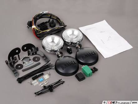

Did anyone installed the Mini Driving Led Lights in the JCW?
The JCW does not have the fog lights and it would be great to add these driving lights that let the car much more beautiful.
JCW F56 2DR HB - NO fog / driving lights?-photo913.jpg
If someone has it, where is the on/off button installed?
Attachment 129380
OOf, to each his own I guess, but that would NOT work for me... Though I do like some way of adding additional lighting, I none the less find the HID LED or what ever you wish to call it, performs extremely well.
Attachment 129380
I have them. Right hand side of the steering column. There is a button once installed to turn off or on, but only when the high beams are on. They are not independent of the main car lighting.
To have it working only with the high beams on sucks a very lot!
The ideal would be to have them working independently or in a worst case scenario, with the lights on, but never related to the high beams on only.
I also did not like the position of the on/off button. It would be better to have it in the left hand side, where you have an empty place (used for front fog lights on Cooper S) or in the center console, on the same switch line of the engine start/stop switch, as the first switch from left to right (I've never seen a Mini with a switch in this place).
Do you know if it is possible to hack this and have these lights working independently and I believe that installing the on/of button in a different spot is a fairly easy task. Do you agree on that?
