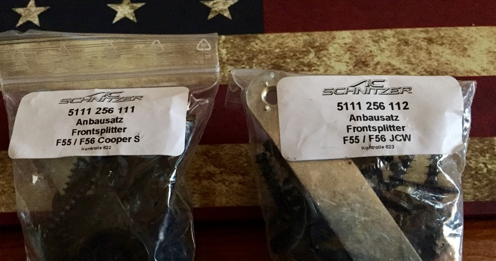

The taller angled spacers showed up as a cylinder with no angle at all (could have been for jcw) not sure. The smaller ones meant for the fronts angled the lip up which would have caused drag and possible damamge. He trimmed the taller one and put it on the front for a better fit. Either way trimming was involved and I'm not near my car or instruction for better explanation tonight.
Well MoJo, I think I found our problem. They sent you and me the hardware package for the JCW. I looked at the english instructions I printed out and it clearly shows the cylindrical spacer (Part I) is for the JCW and the angled part (part J) is for the S. I just talked with their office in CA again and finally got them to understand what I was talking about. They're checking for the correct hardware now and I'm supposed to hear something later today. For a $400 part I expect to have the correct hardware and not have to modify parts to make it fit.

Now, on the the ACS parts. The package came in this morning, 18 hours after talking with the gentleman at ACS. Not bad for CA to VA shipping.
The first picture is of the two packages. The one on the left is the one that came in today and the one on the right last week.

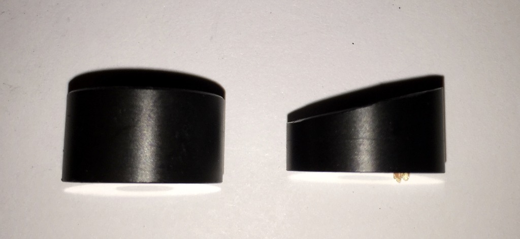

This picture shows the difference in the parts. Radical difference in the profile of the spacers. Left side is JCW, right side is for all other F55/56 Cooper and Cooper S. I would suggest anyone ordering the splitter make sure you have the correct hardware package before attempting install.
Can you please post a picture of the (2) front anchors? They did not work on my car and I ended up using bolts and nuts to make it secure.
