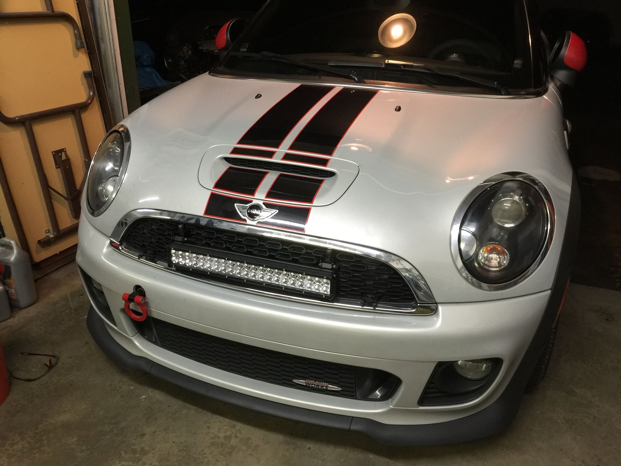

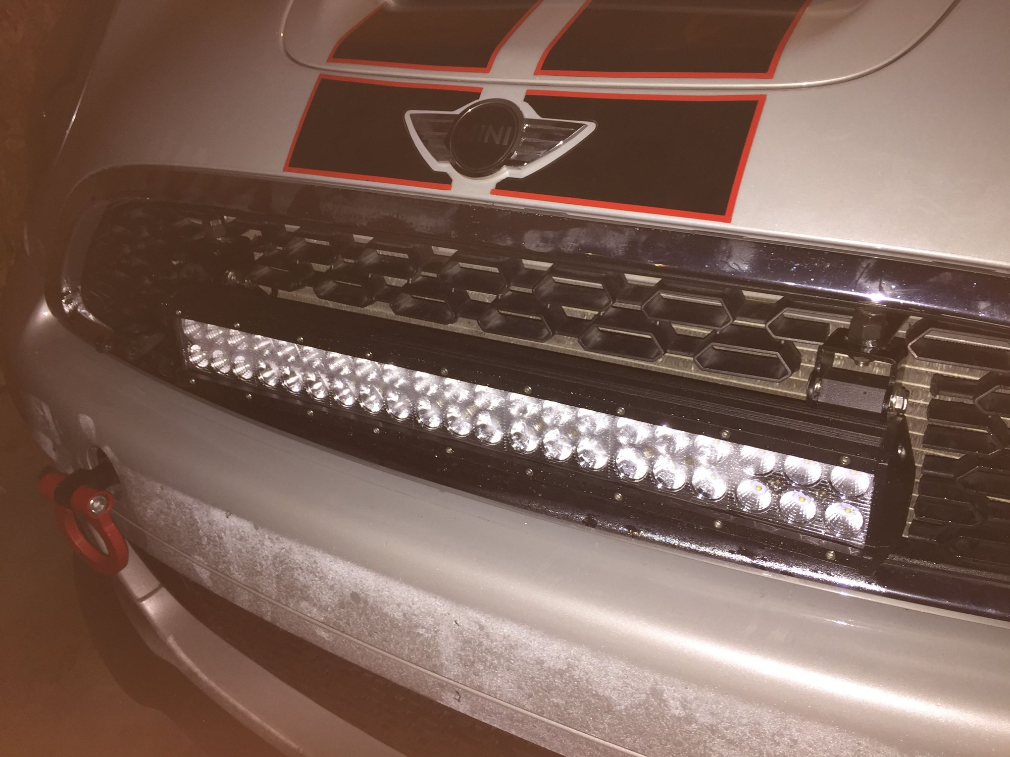

Try a led light bar, I got mine for $36 bucks off amazon and it out powers my hid high beams by a long shot! I wired mine utilizing the existing rally lights wiring so the light bar turns on with the high beams for now, but I also got a wiring harness for around $10 off of amazon to control it manually. As far as install, I made custom brackets using 1/4" steel stock bent it into shape drilled out some bolt holes and utilized the inside hood latch bolt holes to secure the brackets into place, then cut out the grill to fit. Sounds like a lot but for less then $50 and a couple hours of time you can have some amazing light output!
Any picture of this on? Both facing the car, and maybe shining on your garage wall? This looks like a LOT of light!

Those light bars are crazy light. We use those on our off road stuff for out in the desert. No way you could use that on road unless no one was around.
I can't beleive how great the new LED headlights are. By far the best and brighest headlights I have experience.
I would check to see if you could retrofit those.
