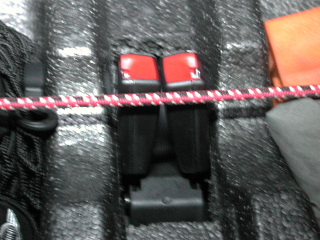

For the Quick fit, you will need to have the rear seat buckle assembly that mounts on the tunnel. The other half of the Quick fit mounts to its own buckles and bolts on the outboard sides of the seats (or where the rear seats would be). I would think all of the mounting points should still be there. Check the NAM market place for someone parting out a Gen 1 MINI. They should have that rear mounting bracket.

NCTRACKRAT, can you take a couple of pix of the Schroth Quickfit pro install? Would love to see what you did and how you fit it with the foam tray and cover.
Anything would be appreciated!!!

Thanks, I saw that thread. Several of the more detailed pix of the instructions are no longer on the site. If you can take a few pix, that would be great. No hurry, track season starts in 3 months....
Here are some quick pics, two from the GP and two from Trackrat. All you need do is remove the side panels from the GP to access the seat belt anchors and install the Schroth adapters, then add the center seat belt assembly from a regular MINI. I use a bungee cord so that the side seat belt assemblies don't drop down. When not in use, the GP carpeted board covers everything up.
