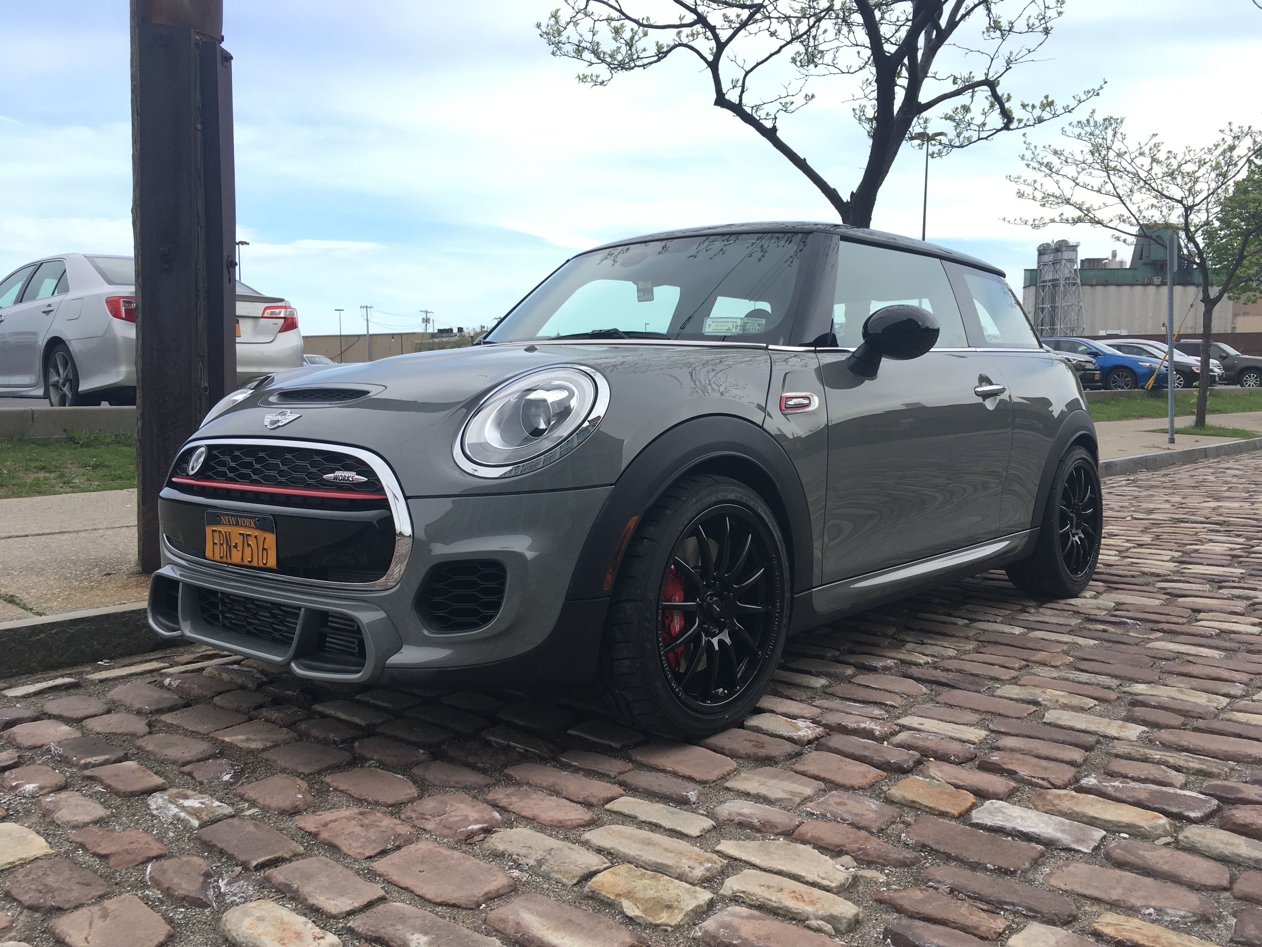

From: Buffalo, NY
So looks like I need a 5mm spacer up front. While it clears the strut, it doesn't clear the caliper. Surprised so many people running it without issues.
5mm spacer worked fine, but looks like a 3mm spacer will suffice for et45 18X8s.
