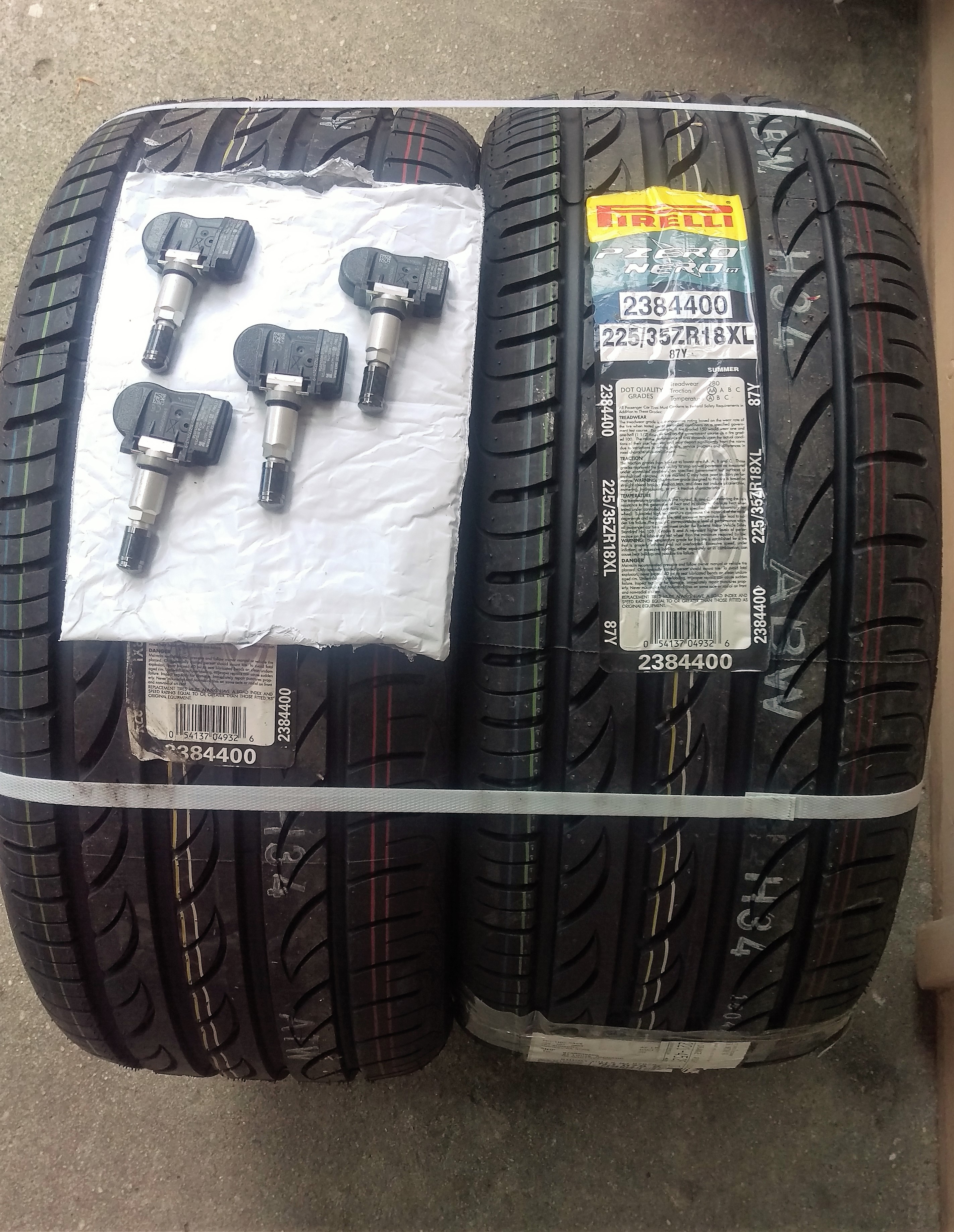

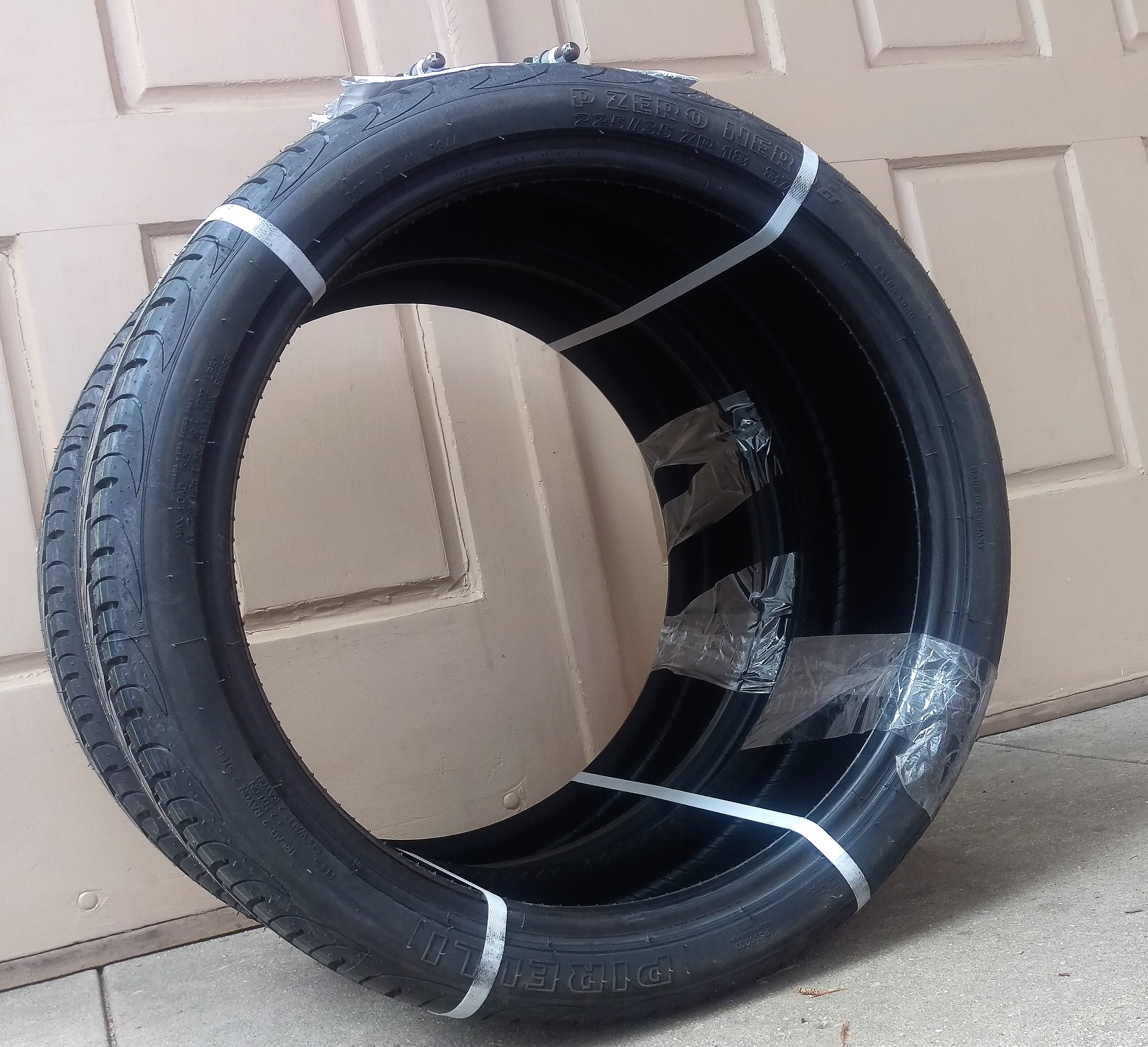

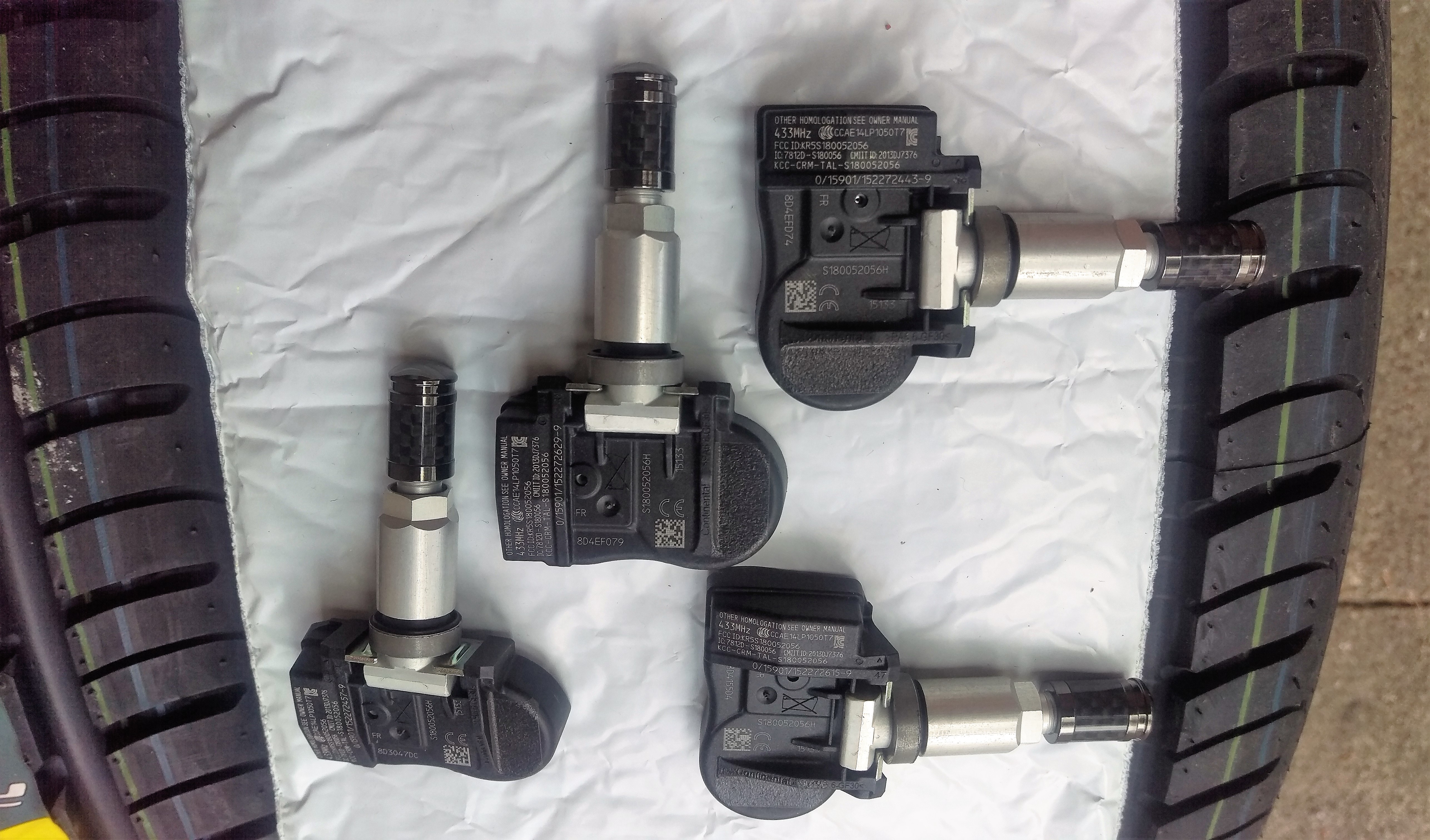

Some new meaty low profile tires to toughen up Johnny CW
WTF- UPS just delivered, but only (2) tires out of (4) tires!!
Oh well . Have to wait another day for mounted up pics. Sorry folks.
Also received Continental 433mhz TPMS for $50.00 each from TireRack!!!!
CF valve stem caps are from Carbon Mini.

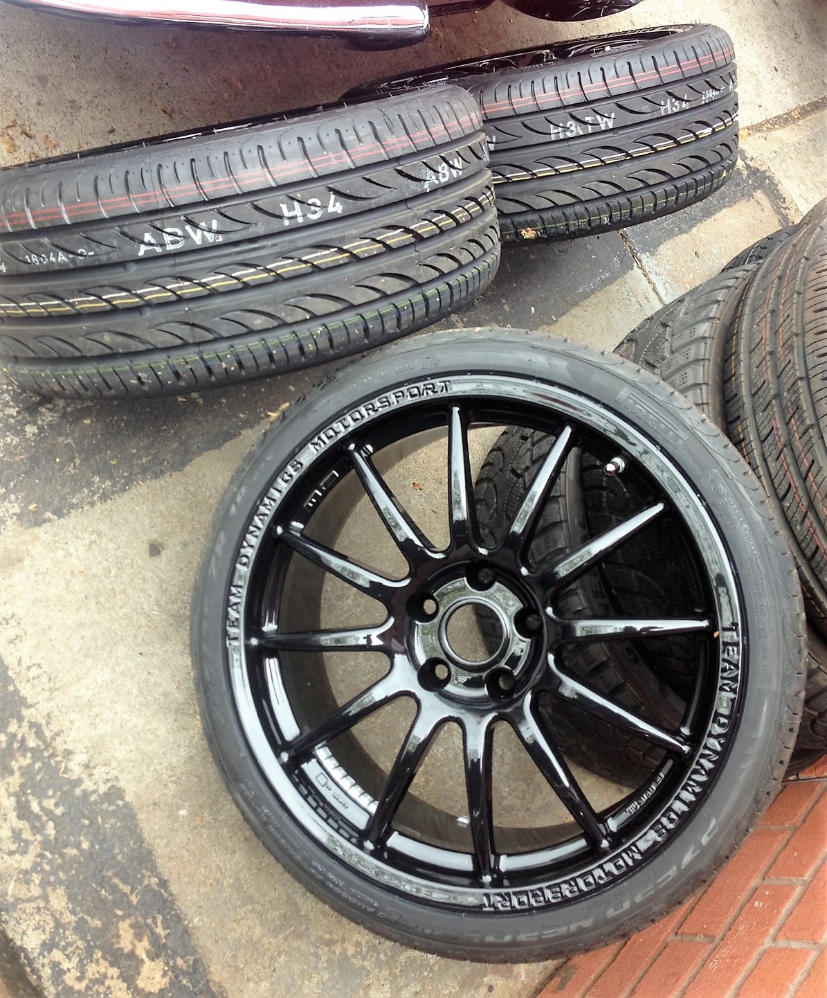

Getting close boys.
My shop just sent me this pic of my 18x8 Team Dyanamic wheels with 225-35-18 Pirelli Pzero nero Gt tires.
Will mount them up on the JCW later today.

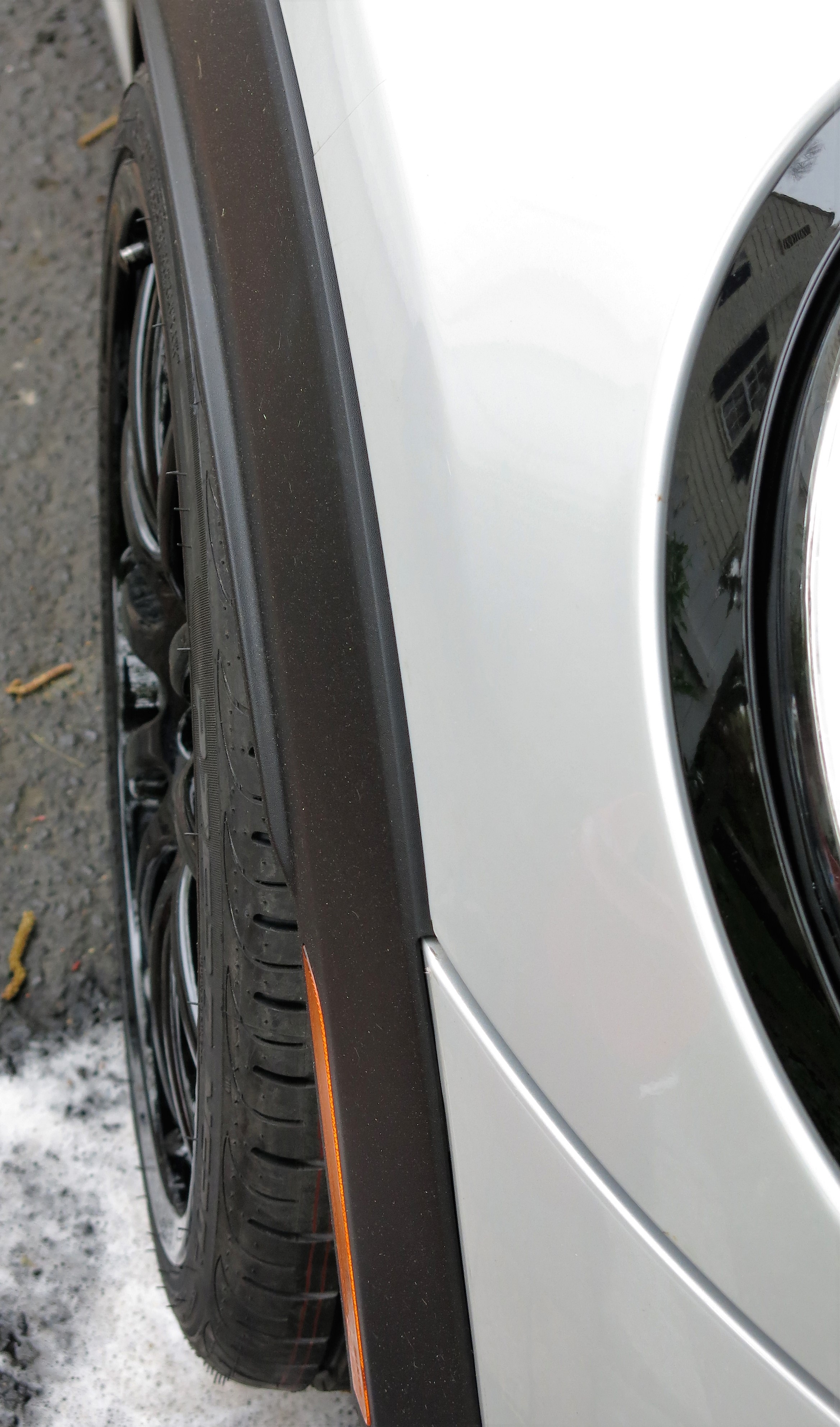

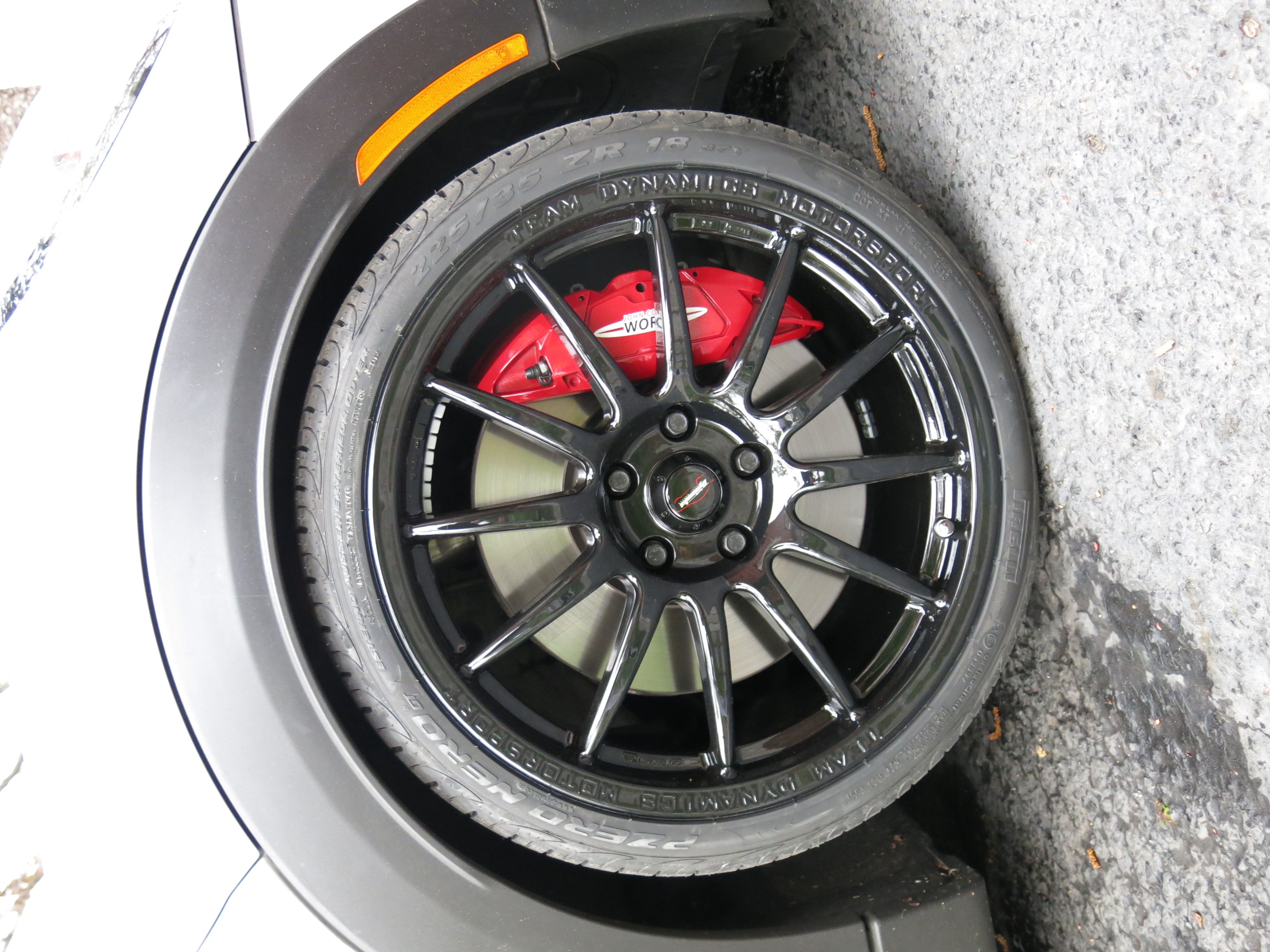

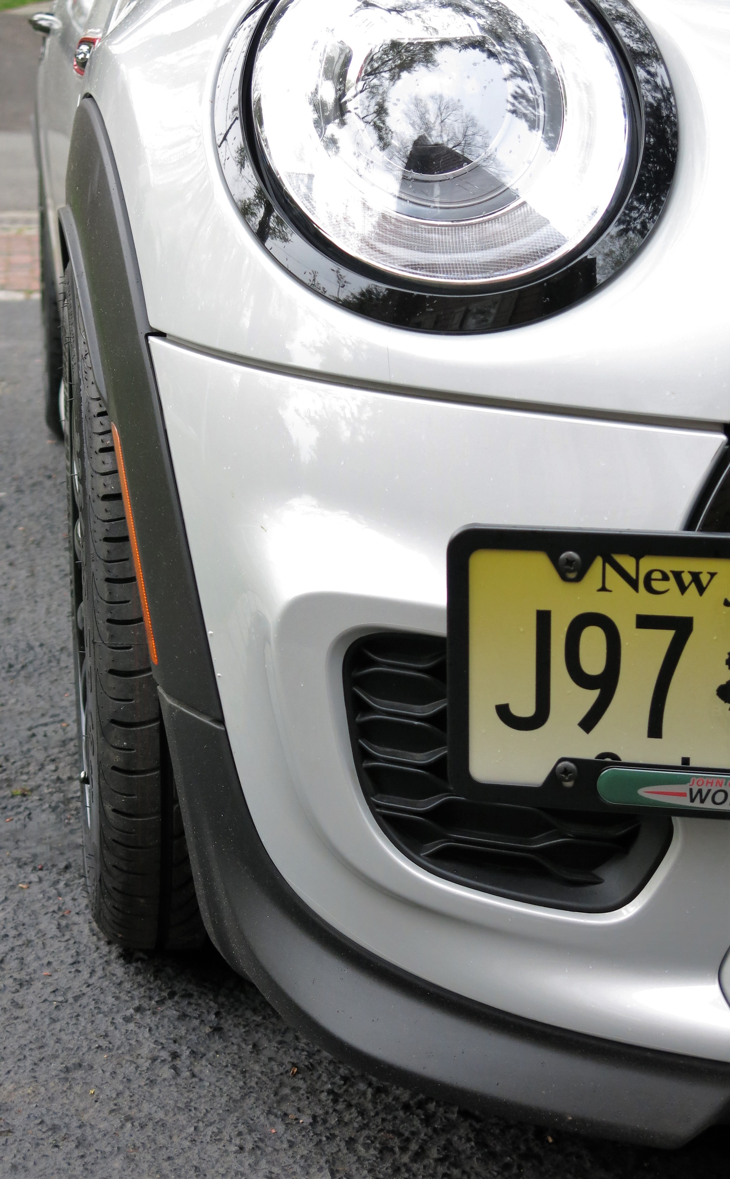

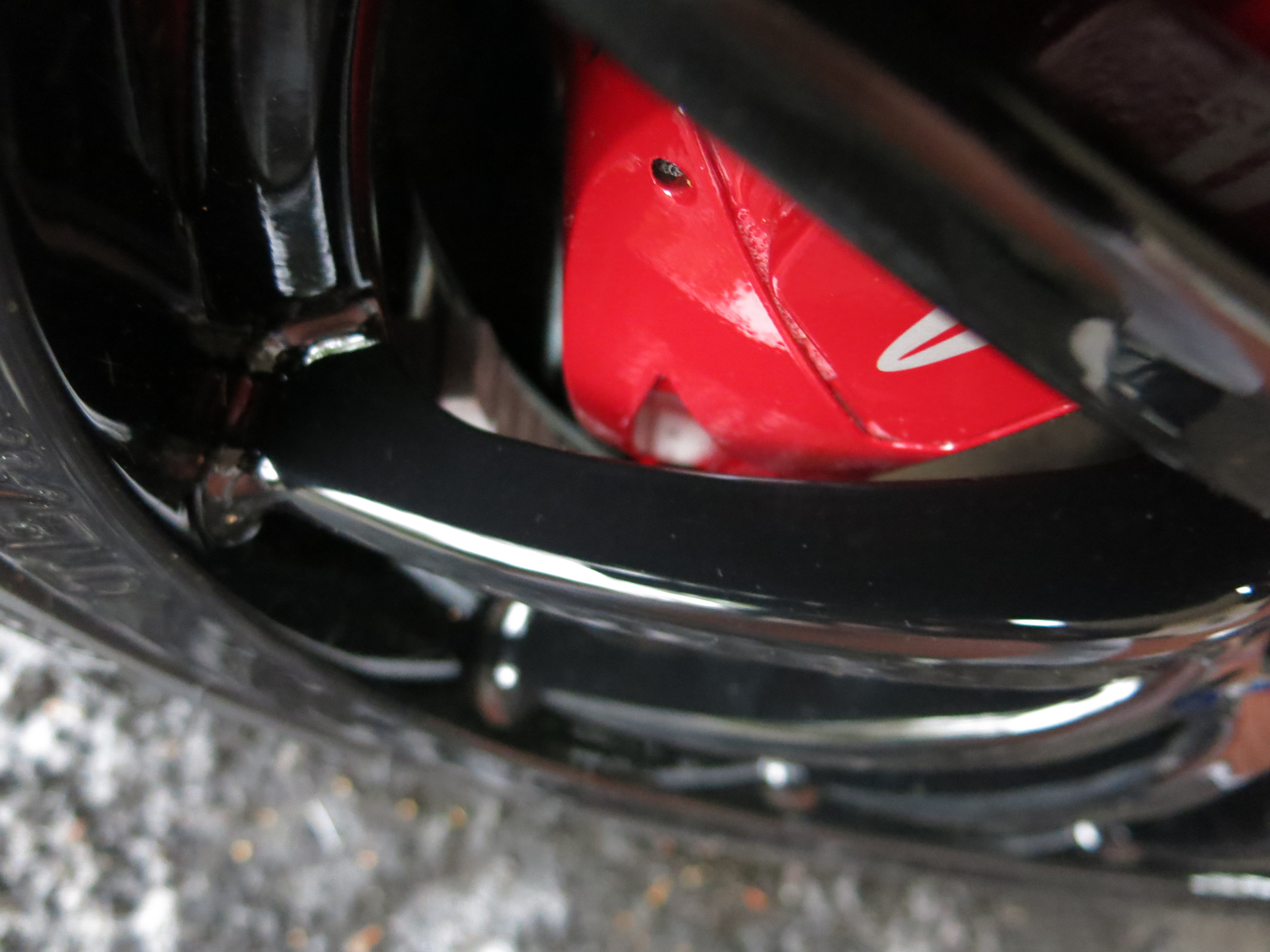

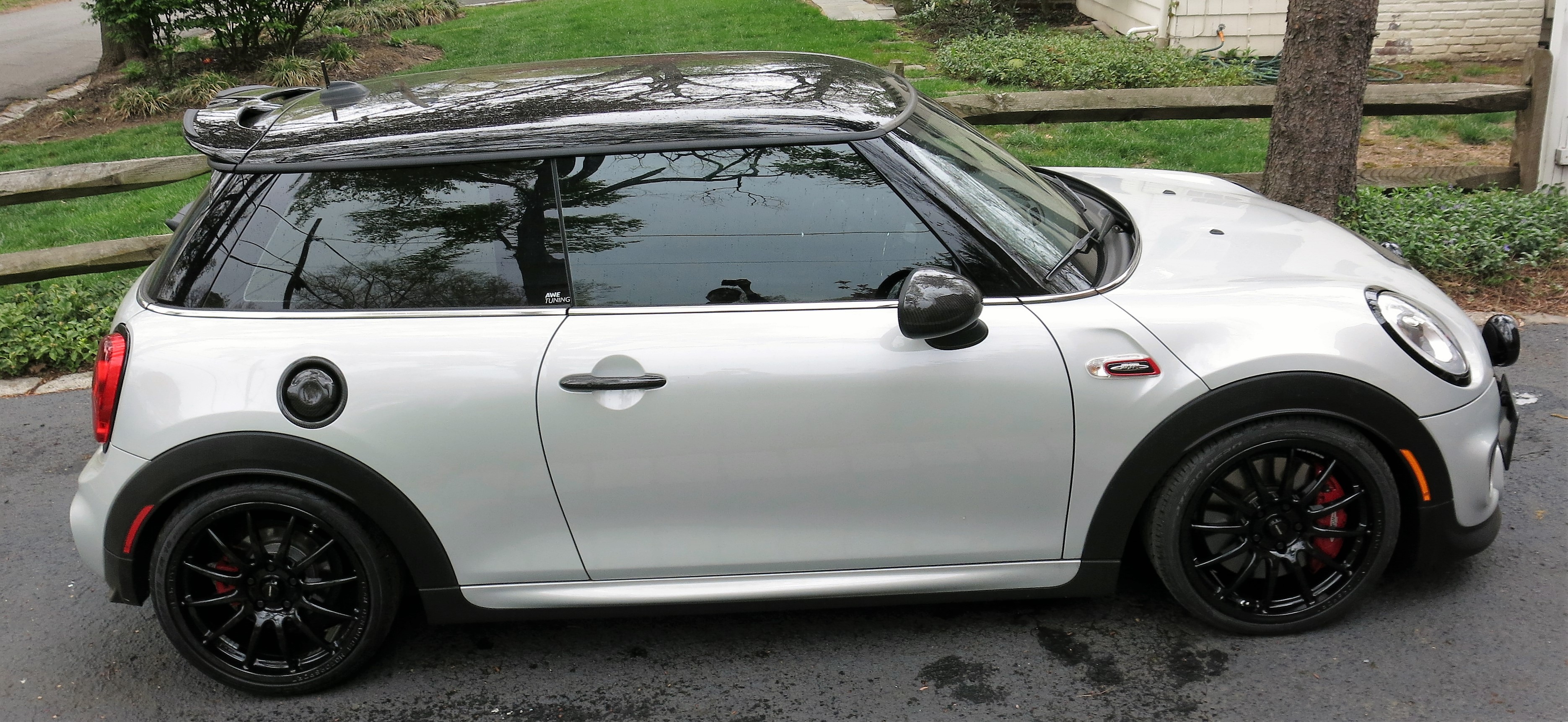

Project completed 223-35-18's on 18x8 Team Dynamic wheels
No rub, no poke-perfect caliper clearance too (less than a few mm) spoke to caliper.
225's are perfect. Anything more would not look right on this 8 inch wheel & offset.
Front looks better than the rear due to the JCW pro coilovers seem to allow more lowering in the front vs. rear.
The handling difference is a night & day due to max. performance summer Pirelli's vs. Hankook run flat all seasons.
OEM JCW center caps did not fit on the Team Dynamics wheels ;-(

I actually have the same wheels but in matte black, 17X8 still waiting in my garage. Did the tire rack tpm sensors sync no problem?

Yup- the Continental 433mz TPMS synced up with out me doing anything.

Quote: No rub, no poke-perfect caliper clearance too (less than a few mm) spoke to caliper.
OWM JCW center caps did not fit on the Team Dynamics wheels.

The ride quality is unreal!!!!!!!!!!, turn in is razor sharp now, no tire roll, Steering is crisp & has a heavy BMW feel now vs. the mushy feel from the run flats.
I highly recommend the Pirelli Pzero Nero GT's
NO spacers- spacers wont work with 45 et and these wheels. They will poke.

Yes, et45 ;225-35-18 Pirelli Pzero Nero GT's.
Not close to strut-no rubbing.
The car is already lowered to max. adjustment on JCW Pro coil overs.
