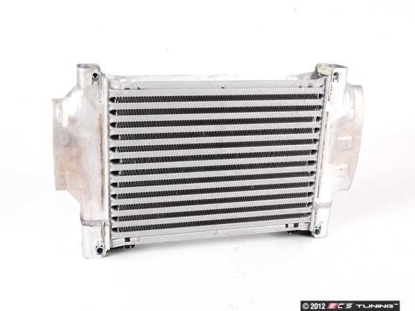

We have had lots of Gen 1 GP parts come through.
These are for the first generation R53 model 2006 JCW GP
http://www.ecstuning.com/Search/34426967671/ES62583/
http://www.ecstuning.com/Search/51166966468/ES82474/
http://www.ecstuning.com/Search/17517565302/ES39176/
