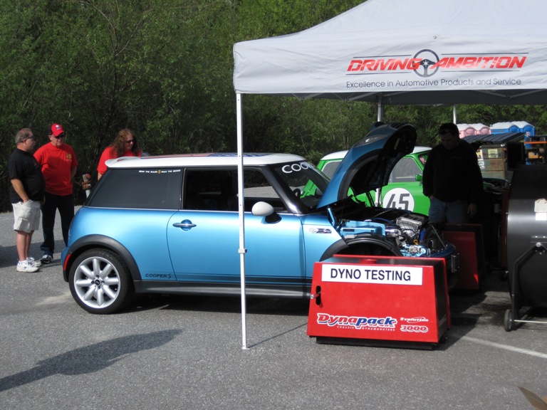

Never had mine dyno'd, but you will not see 210. That's crank HP and even that will vary. I believe 165 to 180 at the front wheels is the range, or there'bouts.
Do NOT allow them to strap it down by the control arms. Period. They're not that strong and can be bent. Beyond that I can't help. But whatever they do, make absolutely sure they know what the hell they're doing. (search uTube for great videos of cars coming off the dyno under power.)

Something just occured to me. Some dynos, the ones that are portable, simply attache to the left and right front hubs. The wheels are removed first. I'd be surprised if a dealer had an actual dyno, so they may be renting one or using the services of some other outfit that has one. For instance, the dyno used at Mini Mania was a portable unit. Before you spend too much time checking on what you want to know, I'd call the dealer and find out what kind of dyno will be used.
Please remember...DYNO readings are only really usable in comparing to themselves...so same dyno, same day since they are adjustable...a good tuner can make one ready ANYTHING), before and after #'s...they are more of a tool in modding than an actual hp#.....
Some give higher HP's #'s, some give lower hp#'s...same car..heck it gives you an idea if it is running right before you mod, than a % gain when done....or comparing cars tested on the same day....

You might get close to 210hp with a custom tune, but with the JCW 210 ECU flash alone you will not. Make sure you get at least 2 or 3 pulls on the dyno for somewhat accurate idea of where your HP is.
