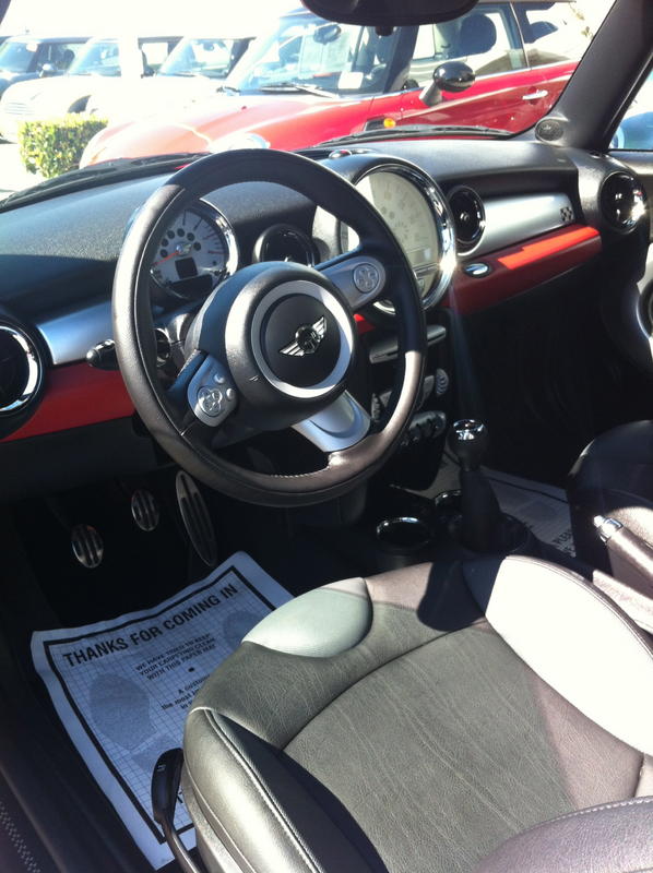

I recently bought at dark silver 2009 r55 JCW and i love it. I was wondering what is the most economical route to added horse power? maybe more low rpm power? im not super educated on these things so if i'm sorry if i sound like a complete idiot . any advice would be greatly appreciated. i have looked around the forum but i havent really found what im looking for.
anyways.. here are some pictures of my new (new to me)
Attached Thumbnails Economical Horsepower Gain?-img_2772.jpg   Economical Horsepower Gain?-img_2769.jpg   Economical Horsepower Gain?-img_2792.jpg
