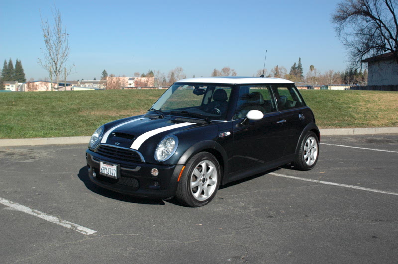

Saw this car at a local dealer and was wondering what was included in the "JCW TUNING KIT". Is that something that's dealer installed? Externally, the car appears to be just your run of the mill 1st gen S (R53). Tia for your inputs.

Well it doesn't have the badges and the front and rear, doesn't have the JCW exhaust or the grey inter cooler cover, or any of the badges under the hood except the one on the intake. Looks like someone bought a JCW intake and is trying to get someone to buy it not knowing what they are getting.
take down the VIN, call a MINI dealer, theyll be able to tell you what has or has NOT been done to that "JCW"...
IMO, if she dont have no badges, she aint no JCW!
anyone can BUY one of those badges on ebay btw... A REAL JCW will have the following:
JCW intake (reach in the back of it, feel for a flap)
JCW injectors (blue)
JCW exhaust (should have Tips that say so, and a true duel exhaust setup)
JCW computer tune (when you drive it, the flap will open at around 4k rpm, you will "feel" that surge)
JCW head (that, well, you cant tell just by looking)
JCW Brakes (big red freakin brakes that say JCW)
suspension was "additional" on the JCW, not having that doesnt not make it a JCW. not having the rest, doesnt make a jcw...

03-04 JCW's have no intake, injectors, or brakes. The '05 started the factory option JCW kits. Before that it was dealer installed.
