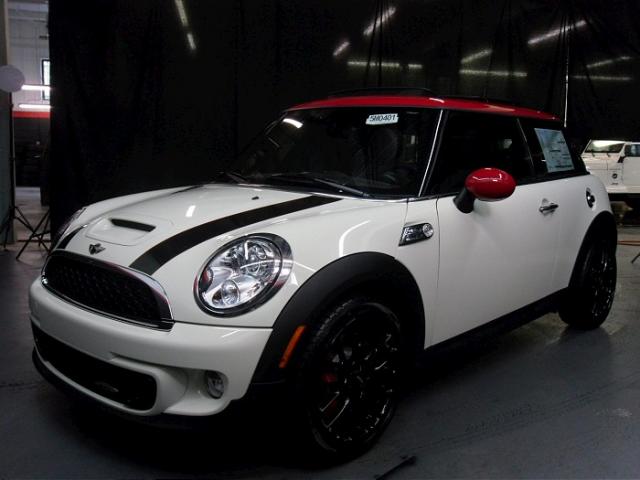

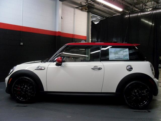

Here are pictures of the car at its current home in Raleigh. I'll take better pictures of the car once it's in my stable.
Attached Thumbnails MCS vs JCW-2103672829.jpg   MCS vs JCW-2103673041.jpg   MCS vs JCW-2103673073.jpg

phinzup, interesting to see the paint on the walls match your car.

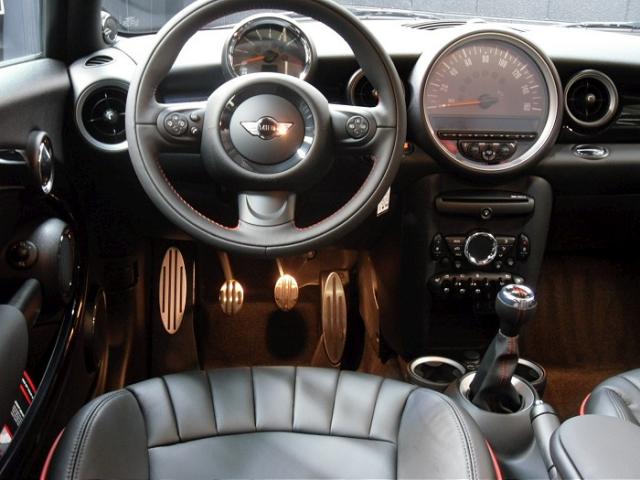

Looks awesome. I would like to see more interior shots, especially of those gauges. Makes me want to trade my S in

This is the best couple of shots of the gauges for now. Again, more when I have it in my hot little hands.

LOL. I hadn't really noticed that, but you're right. That's pretty funny.
