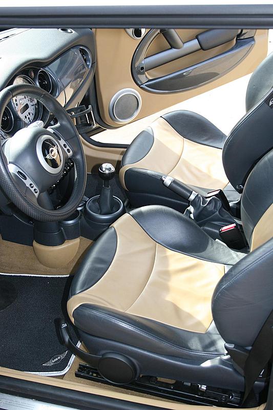

Someone on Craigslist is advertising a 2004 JCW Mini with 54,000 miles. After talking to him, he emailed me two pictures, but the pic of the exterior is corrupt; therefore I've only seen a pic of the interior (attached).
Now, as you can see, there's no JCW badge below the steering wheel. I asked the guy if there was any JCW badging, anywhere, and he said no. What makes him think it's a JCW, then? I guess that's what he was told by the previous owner. Anyway, a friend told me that there should be JCW somewhere on the exhaust pipes (unless they've been changed), so I asked him to check that.
Pending more pictures, which I should receive tonight, can anyone advise on any other ways to identify exactly what this car is/isn't? It's a 2 or 3 hour drive, so I want to be reasonably sure what to expect before going to see it up close. Thanks!

You need front pics, rear pics, close up exhaust tip pics, and a few engine pics to be able to tell. Nothing in interior that would identify a JCW.

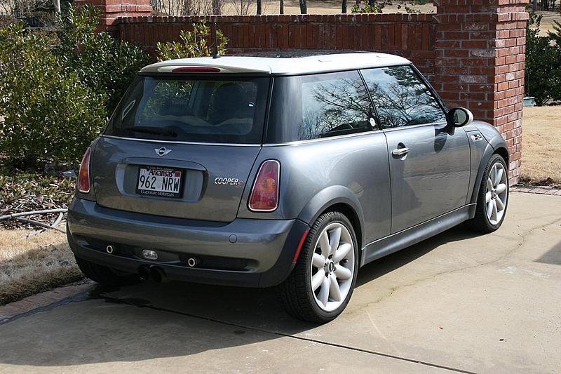

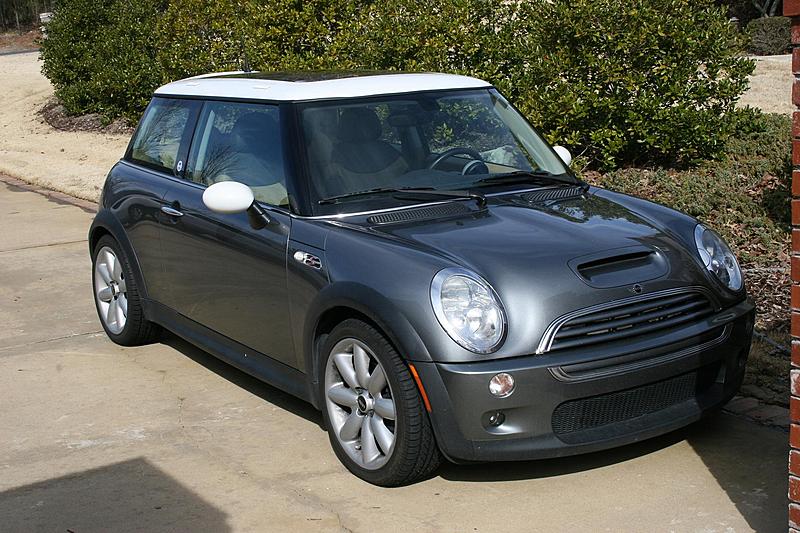

Here are the latest pics.

those are the exhaust tips from the Works exhaust system.
a photograph of the top of the engine should show an acrylic plate on the top of the intercooler, right hand side, with prominant Works emblem

Use caution.
1-no red caliper
2-no badges
3-the exhaust tips indicate that he has an exhaust or tip which can be purchased seperately
4-the photo is hiding where the badge should be on the front
5-if he has it flaunt it does not seem the obvious mentality for the seller
just my five sense.

Those exhuast tips look too big. Almost looks like Miltek or Invidia.
There should also be the JCW logo on the air intake. (although this year, it was installed by the dealer ,if at all).

I doubt this is a JCW MINI.
