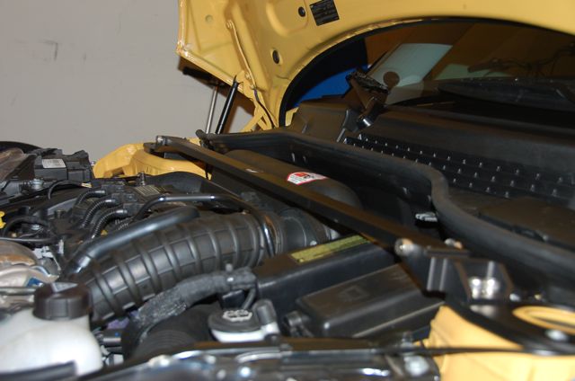

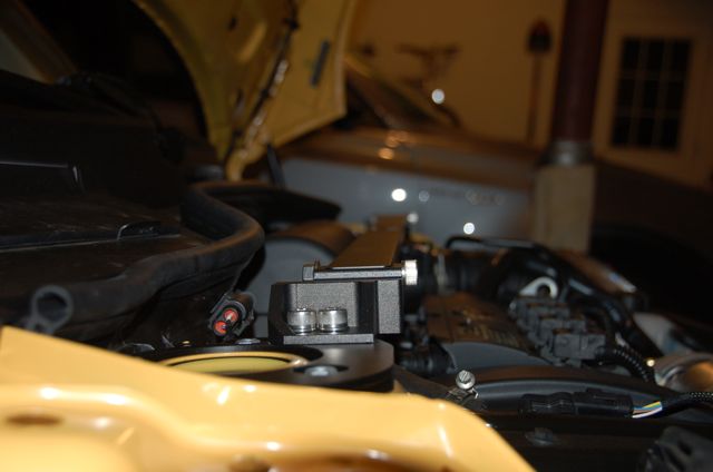

Originally Posted by krim
any chance of a photo from the side? i'm wondering if it'll clear the CAIs out there.
Not sure if this will help, but here goes. You can always check with M7 for your specific CAI.
Attached Thumbnails JCW strut brace vs others ???-dsc_0348.jpg   JCW strut brace vs others ???-dsc_0349.jpg   JCW strut brace vs others ???-dsc_0350.jpg
Old Aug 14, 2008 | 05:26 AM
krim's Avatar
krim
Posts: 866
From: SoCal 626
It does, thanks for posting!
