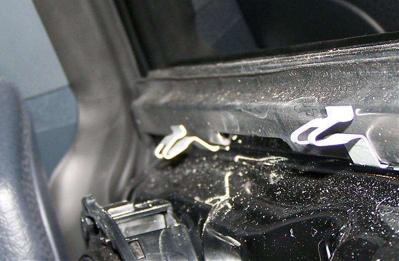

Oh no! I think I did something wrong. The metal clip on the door is bent, and the plastic notch on the panel is bent as well. It's the one closest to the tweeter. I've only removed the passenger side so far. What did I do wrong? Can I fix these? Will it still install properly? I'm leaving some pics of the damage. Also, I'm going to need to drive around without the panels for a little while. What can I do with the light that was in the bottom of the panel. That thing gets freakin hot! Thank you.

It looks like you can just bend the metal clip back into place. I don't know about the plastic part though.
It was likely like that when installed at the factory. I took off my panels and found several misaligned and crushed plastic clips. Not a big deal, just bend it up, and align it when installing.
For the light, I'd just tape it to the door.
